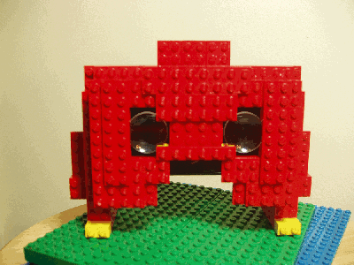

Step 1: Eyepiece Module
The first step is to make the eyepiece module which will hold the lenses a very specific distance apart and not block them while in use.
The photograph is illustrated to show the eyepiece module all the way around. The yellow pieces on the green platform are only there to elevate the base module and are not part of the project.

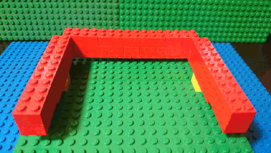

Step 2: Base Module
The second step is to make the base module which will hold the eyepiece module a very specific distance off the phone's surface so the lenses can properly focus.
The height of the base is the focal distance of the lenses. Some height is added by the eyepiece module. Do not change the height of the base or the lenses will not focus.
The width of the base is the same as the height of the phone used for testing. Only change the width of this step if absolutely necessary.

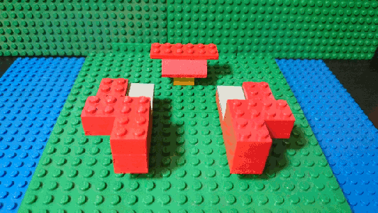

Step 3: Support Pieces
The last step is to make the support pieces which will hold the phone or iPod Touch in place. These pieces can be modified as necessary to better fit the device. The phone used in this project was a Sony Xperia Z1S which is on the larger side of phones.
The photograph is illustrated to show the support pieces all the way around. The yellow pieces on the green platform are only there to elevate the support pieces and are not part of the project.
The diagram shows the assembly instructions. Start at the outside and work inward.
