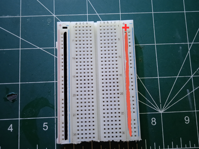

Step 1: Power Rails
were using these as power rails
you can give the circuit
5-12 v of power
