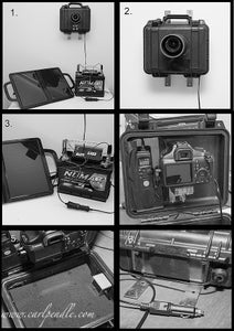

I did find one or two people trying long term time-lapses and I looked at what they did and adapted a system that would work for me and my client. Above is a basic breakdown of what I've come up with.
1. This is the finished set up. We have the camera in a watertight case connected to a battery which is then connected to a solar panel to keep the battery topped up.
2. Here is a close up of the camera housing with metal brackets fixed to the back and attached to the wall.
3. The battery is a leisure battery (not a car battery) which is perfect for providing a trickle of power to the camera. A camera doesn't use that much power but when you're leaving it outside for weeks at a time it will soon weaken which is where the solar panel comes in which will keep the battery topped up.
4. Inside the case is a Canon DSLR attached to two 'L' shaped metal brackets. Initially I had plans for a quick release bracket to go inside but room was so tight that I had to find a wooden base to which everything is attached. Running into the camera (on the left) is a intervalometer that I can program to set the interval of my timelapses. This isn't the Canon one which is very expensive but a cheaper one from Amazon that I've used before and never had any issues with.
5. Here you can see the top of the camera and to the right in the bottom of the case is a volt convertor. The voltage from the leisure battery is 12 volts and much too strong for the camera which prefers 7-8 volts. So what this handy gadget does is convert those 12 volts into 7 volts. There is a dummy battery in the camera that leads to this converter.
6. Finally, the bottom of the case I've fitted a hole and rubber washer that takes the lead into the battery outside. As you can see it is just a cigarette lighter adapter which then feeds into a cigarette lighter socket to the battery.
