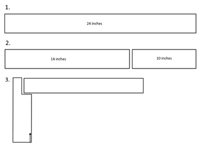

  1. Take your paper tube and cut it into two sections, one 14 inches long and the other 10 inches.
  2. Take the 10 inch section and measure 1.5 inches and cut horizontally half way through the tube, then vertically to cut the section off the tube.
  3. On the other end of the 10 inch section cut a slit .75 inches vertically on one side of the tube, then make a small hole for the cord to go through
  4. Place the 14 inch tube in the cut out portion of the 10 inch tube and glue it in place.

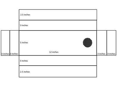

  1. Take your corrugated cardboard and cut it to the dimensions shown.
  2. Fold the cardboard into a box and glue the overlapping flaps together.
  3. Cut a hole (big enough for the tube to fit) on one end of the box.
  4. Cut a piece out of the side of the box for the cord to go out through.

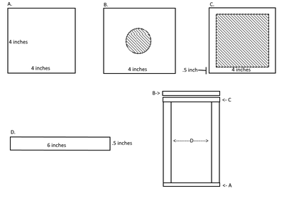

  1. Using the paperboard, cut out the following pieces...
  • A. 4x4 inch square
  • B. 4x4 inch square with a circle cut out in the center to fit the light bulb socket
  • C. 4x4 inch frame that is .5 inches wide
  • D. 6x.5 inch pieces (x8)

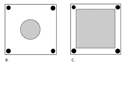

2. Glue the magnets as shown
3. Cut out 4 piece of paper (4x6 inches) and glue 2 "D" pieces on either end (repeat step to make 4 panels)
4. Assemble lantern as shown in the picture.

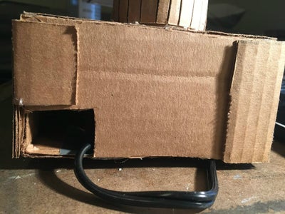

  1. String cord through the frame with the socket on the shorter section of the "L" with a little bit of the cord sticking out for the socket to hang down.
  2. Pull cord out the bottom of the frame and string it through the hole in the base and then out the hole on the side.
  3. Put end of tube in the hole in the base.
