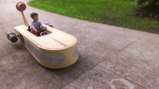

This was my quick and dirty Landspeeder X-34 for my sons 6th birthday party. I didn't plan on an instructable, so the photos are a mixture of construction and deconstruction. (it took up ALOT of room, I needed the garage back) It's also my first instructable, so excuse the rough edges.

created the engine pods out of wood scraps and gallon or two flower pots.
Step 8: Final Detail
I felt that it needed a little something extra in the detail area so I decided to make a bumper sticker that I think any young Luke would appreciate.
