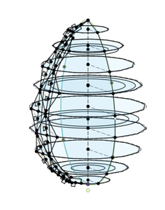

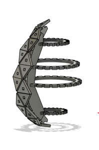

In order for these eggs to get their nice smooth shape, they need to contain quite some parts:
- 4 different rings, one of each, for the core structure
- 2 sets of 12 ribs that connects to the rings
- 18 sets of 12 triangles that connect to the core structure
Because of the large amount of parts, it would be very convenient if no glue is needed to put this thing together. Luckily there is a way to do this! If we account for the amount of material that the lasercutter cuts away (kerf) we can cut parts that tightly connect together, just using friction.

Step 2: Building the Core
Once everything is cut out, you can start building. Take the four different rings, and the two sets of 12 ribs. If you cut the labeled files, it should be quite straightforward how they go together. If you have the non-labeled version, you can use the labeled file for reference. Every only fits together one way, so it should be doable. Make sure that the entire core is pressed together tightly. You can do this by looking at the top or bottom. These should look like they ar nice round circles. Do not hammer these sections down, you could potentially damage the pins.

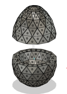

If you feel like an extra challenge, I still have some things that I did not have time for to implement yet, these are:
- Creating a map that allows you to wrap images around these eggs, by engraving parts of the image on each triangle individually, before putting it together. I was thinking on wrapping an engraving of Starry Night on it for example, but I have no idea how it would work out
- Creating a box out of one of these eggs. As you can see from the third image of this step I did get to making a design that allows you to take the two halves apart. It was however quite fragile, and I did not get to improving it yet. Furthermore, this would just be a container where you just pull the lid off. I'd love to design it in a way in which it contains a twist and pull mechanism that closes and opens the lid. There is however not to much space to work with, but it sounds fun.
