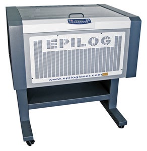

  • Laser cutter (I used a 45 watt Epilog Helix laser cutter).  I assume in this instructable you know how to use a laser cutter.

Using the laser cutter, cut out one set of parts in 1/8" black acrylic and another in 1/8" white acrylic using the "THINK Sign" Corel Draw file.  The laser cutter I used was a 45 watt Epilog Helix laser.  I used the following settings for cutting - you may need to use different setting depending on the laser cutter you are using.
  • 1/8" acrylic:
    • Vector: Speed 10, Power 90, Frequency 2500
Use the laser cutter to to cut out the jig out of 1/4" acrylic using the "THINK Sign Jig" Corel draw file.  I used the following settings for cutting:
  • 1/4" acrylic:
    • Vector: Speed 6, Power 90, Frequency 5000
