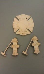

Fireman themed phone holder. Fire axes leaning on fire-hydrants put together on a Maltese cross. Works with most smartphones portrait or landscape. Made with 1/8 inch craft wood cut on a laser. Great for watching movies or just surfing the web.
This particular version is engraved with STATION 12 but could be customized with almost anything the sky is the limit.

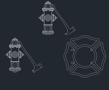

Step 1: Drawing Files
The first step was to create the drawing file. I started with Auto-desk Inventor then transferred Auto-Cad. This file will be available for download. Both hydrants need to be cut twice with one inverted as seen in the the next step. I did not do that in the download as it is much easier for us to do in the laser software.
Step 2: Laser Cutting
This particular version was cut with a (laser). The red lines are cuts where the black lines are only engraved. With this particular laser:
Red= Power 100% Speed 2
Black= Power 100% Speed 35

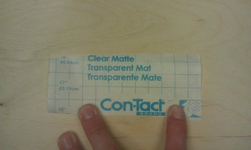

Step 3: Sanding and Gluing
There are two options, you can either put a thin plastic layer on the wood before being cut or it can be sanded with a very high grade sandpaper. Both get the same result of removing the smoke created by the laser.
After sanding/removing the plastic, two of the four hydrants need to be glued together, one with tabs and one without to make a sandwich.
Gluing to the base is optional as the tabs stay in quite well without glue. If not glued it can be broken down anytime.
