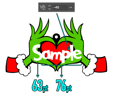

Within your Vector graphics application, open or import the file provided called: grinch-heart.ai or grinch-heart.svg. Use the TYPE tool to add a name of your choice over this base art. Doing so will help you visualize how big, or small, the font can be. Names with a few letters can be larger... while names with many letters must be smaller.
Sometimes it's best to capitalize the first letter and use lowercase letters for the remaining letters and other times all caps look best. There's no wrong answer here.
Pro Tip 1: If you're using cap/lower, increase the size of the lowercase letters because this provides a more balanced word.

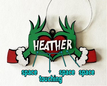

Pro Tip 2: Remove space (kern) between the letters so they touch each other. In Adobe Illustrator, an amount of "-30" to "-60" is usually enough. When the letters touch, it makes the assembly of the final ornament much easier. Think about it... do you want to stick each letter, one by one, on the ornament or would you rather simply stick one entire word?
Look out! Some letter combinations simply must have a space, such as the name "HEATHER"... if this is the case, don't sweat it. Just try to minimize the number of spaces.

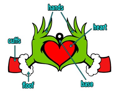

To make 42 ornaments, you'll need to cut 378 parts:
  • 84 cuffs (42 left & 42 right)
  • 84 floor (42 left & 42 right)
  • 84 hands (42 left & 42 right)
  • 42 hearts
  • 42 bases <-- Remember: No sheet tape on the back of the base pieces
  • 42 unique names

Place a black base part in front of you.
Start with the cuffs. Peel the white wax paper off the back and stick to the base.
Next, stick on the Floofs.
Next, stick on the Hands.
Next, stick on the Heart.
Finally, add a personalized name.
