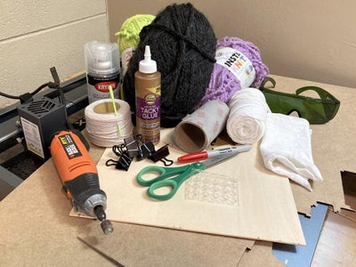

Materials
  1. Scrap wood or hardboard (at least 22" x 20" in total)
  2. Non-stretch cotton cord (at least 11 yards)
  3. Colorful yarn (try to maintain the same thickness and type if you're a beginner like me)
  4. Lint-free cloth
  5. Tacky glue or wood glue
  6. Clear acrylic sealer (like Polycrylic)
  7. 2 pieces of letter sized card stock (or use the front of a family-sized cereal box)
  8. Rubber bumpers
Tools
  1. Vector drawing program like Adobe Illustrator
  2. Laser cutter
  3. The loom, comb, tapestry needle, and hanging rod we'll be cutting
  4. 220 grit wet/dry sandpaper
  5. Binder clips
  6. Scissors
  7. Fine tipped marker
  8. Yarn needle

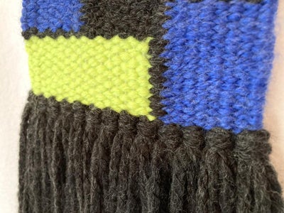

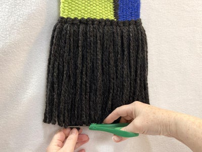

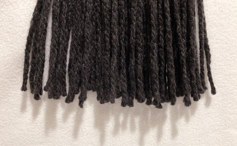

  4. How to add fringe and how long to make it: It looked pretty easy to add fringe, but deciding the right length is all about creating balance. You don't want the fringe to take away from your tapestry but you don't want it so short or bland that it doesn't really add to it either.

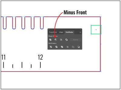

Before I cut those out of the rectangle, I copy-pasted the whole thing and flipped the notches (using the Reflect tool) to face the bottom so I could create the bottom of the loom. I left the ruler at the top of the bottom piece, but moved the numbers below it instead of on top.
Then I used the Pathfinder tool, made sure those notches were in front of the rectangle, and used Minus Front to cut the notches out. I did this for both pieces.

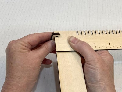

I decided to create the sides first before making any cuts for the connecting feet.
Sides of the loom: This was easier than the top and bottom because there are no notches and no rulers. I just drew three rectangles 1.5" wide and 15", 19" and 21" long. I only drew three for now instead of doubling them, because I know I will be adding the slots for the connecting feet later and those slots will need to be on opposite sides of each other. This wouldn't typically matter since you can just flip what you cut, but the laser cutter tends to singe the bottom and I want all my front-facing pieces to be prettier.
Connecting feet: I wanted to be able to remove these and attach the longer sides when I'm feeling bold enough to do so. So I decided the best way was to make pieces that slide into slots cut into both the sides and top and bottom pieces and also act as feet to raise the whole loom. These feet would protrude down which will make them easier to grab and remove when I take the loom apart. The design for these is simple, but then I needed to go back to the top, bottom, and sides and add the notches that they will slide into. Those notches need to line up perfectly for these to work.
Also, I decided I wanted them to extend further across the bottom of the frame pieces because I thought it might have a better grip on the loom and keep it sturdy. And I realized it might be easier to work if the loom angled up toward me. So I decided the top feet will be longer than the bottom feet. And and, as I was considering this, I thought I needed to make them thicker so I could add rubber bumpers on them to keep the loom from sliding around on the table. Because I'm using 3mm thick wood, I would need to cut two of each set and glue them together.
NOTE: When designing pieces that will fit together, you need to not only consider the ACTUAL thickness of your wood (use digital calipers not the manufacturer's word for how thick the wood is), but also how much you will be removing by laser cutting and sanding the pieces. If your wood is actually 2.8mm instead of 3mm or if you have a really low-powered laser cutter that needs to make several passes to cut the wood, you might design the spaces to work with 2.7mm wood rather than 3 or even 2.8mm. It doesn't seem like much, but every fraction of a millimeter counts if you don't want things to be wobbly. If you are going to make the feet permanent by gluing them in place, an exact fit won't be as necessary, but would be helpful.
So, considering all these details, I first took one of my side rectangles (in a vertical orientation) and aligned it to the top left of my top piece. This wasn't completely necessary but it allowed me to visualize how I want to make the connecting feet. Seeing how the loom will look after the pieces are connected helped me see how far up I should connect the feet and how far over I can extend them above and below the frame pieces.
I knew I needed a slot 6mm deep since I'm gluing two pieces of my 3mm wood together to create each foot. So I created a box .25" wide by .2362" (that's 6mm) tall. The quarter inch measurement is just a random width I came up with that wouldn't interfere with my weaving work but felt wide enough that the feet would securely latch on.
That box will create the slots on all 4 frame pieces that the feet will go over, so I drew another box that I aligned to the top of the top frame piece and made it 6mm tall (just because that felt like a good distance from the top). I aligned my quarter inch box to the left of the top frame piece and below the 6mm box at the top so that the slot that I'm cutting for the feet to slide into is 6mm from the top, 6mm deep, and 1/4" wide. Then I copy-pasted and put that box in the same location on the opposite side of the top, both sides of the bottom (but 6mm from the bottom instead of the top), and on all three of the side pieces (while in a vertical orientation), 6mm from the tops and bottoms.
I used Minus Front in the Pathfinder tool to cut the slots from all the frame pieces. Then I copy-pasted the three side pieces, and used Reflect to create their opposites.
For the actual connecting feet, I drew a box 1.25" wide (since the side frame pieces are 1.5" wide and I don't want the feet to extend past the side edges) and about 1-3/8" tall. That just felt like a good height to me for the top feet. I measured 3mm from the top and put a box .25" wide by 6mm tall under that. That's where the feet will slide into the slots on the frame pieces. I created another box to the right of that one and extended it off the right side and cut it from the big box using Minus Front. I took the top two nodes on the top right and brought them back so they were .5" from the left side. This is the part that will extend over the top of the frame pieces. Then I brought the middle node on the right in a little so that it was about an inch from the left side. This is the part that will extend directly under the frame pieces. (I realized later I didn't have to do this but it's done now, so that's that.) Then I rounded all the corners except for the ones directly touching the frame pieces. I copy-pasted and reflected to create its opposite. Then I copy-pasted those to create their doubles that I will glue together. These are the top connecting feet.
For the bottom connecting feet, I just took copies of the top ones and drew a box over the bottom so that they would be 5/8" tall after I cut them. I cut the feet using Minus Front and then rounded the bottom corners.

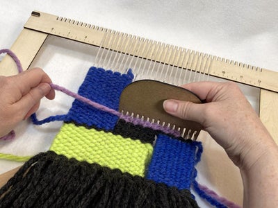

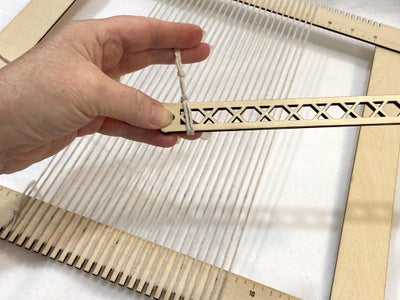

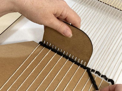

Weaving comb: Using the bottom piece of the loom, I removed the ruler marks, and trimmed off the edges (using a box and the Minus Front option in the Pathfinder tool) to make it about 4" wide. At exactly 4" there was a little bump on each end from cut notches, so I removed those to make the edges smooth.
I grabbed the top two nodes and moved them up to be 2.25" from the tops of the notches. Then I grabbed the lower nodes of the notches and pulled them down to make them .75" long. I rounded the top of the comb to make it more comfortable to hold. The whole comb is now 3" tall.
The most painstaking part of the comb was making the end of each tine narrower than the tops. It wasn't hard, just involved. I selected the nodes at the bottom of one tine, used the scale tool, selected the horizontal only scale, and reduced by 70%. Once you set the percentage, you can just grab the next set of nodes at the bottom of a tine, hit the S key on your keyboard for Scale, and then hit return twice (or enter if you're on a PC). And just keep doing that for each and every tine. Then, I selected all the nodes at the bottom of each tine together and used the dynamic rounding tool to round them off so they aren't sharp.

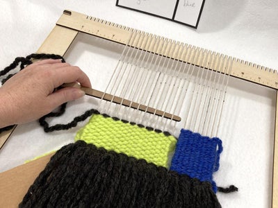

Tapestry needle: For this I figured a little less than 2/3 of the width of the loom would be good. I didn't want it too long to be hard to handle but not too short that it makes weaving more laborious. So, I drew a rectangle 7" long by .5" wide, narrowed the bottom quite a bit (the same way I did each tine on the comb by using only the horizontal scale option), and rounded off all the sharp corners. Then I drew a rectangle 3/8" long by 5mm wide (to make sure I could fit some chunky yarn in) and centered it vertically with the needle. I rounded all the corners and put it a reasonable distance from the top (I just eyeballed it to make sure it wasn't too close). That was it for this one.

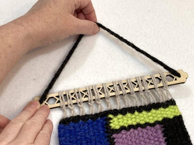

Hanging rod: Honestly this could be just a rectangle with 3mm holes at either end. But I like to make things fancy so I added a cutout interior. I know some of it will get covered by the warp strings when I hang them on the rod, so I didn't do anything too fancy.
Then I watched a video on how to hang your mini tapestry to a hanging rod and decided I could add a tiny bit of detail to the ends without making it too hard to put my tapestry on it.

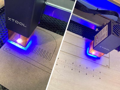

Cut the loom
This part was easy. Open the files, tell the laser to cut. Practice new crochet stitches while I wait.
Seriously, though, my scrap wood is actually hardboard that is 3mm thick. This is what I used at my local maker space with an 80-watt laser cutter. However, I quickly (quite slowly in fact) learned that my very low-powered laser cutter at home wasn't going to cut it (pun intended). I started with a smaller piece and tried cutting just the comb and tapestry needle from it. It took 9 passes.
HERE'S A FUN FACT: The more passes you make with a laser cutter, the more soot you create on the cut edges.
So, after what was literally hours, I switched to the basswood I have. Basswood is considered a soft hardwood. You can actually cut it with an Xacto knife. I use it a lot for many of my laser cut creations because I mostly create decorations, not something to be used in this manner. My concern was that it might snap with the pressure that I expected to put it under. I would suggest you use a harder hardwood if you have it. But as time would tell, the basswood actually held up pretty well.
Since I didn't know how heavy the tapestry would be when I was finished, I decided to cut two of my hanging rods to glue together, hoping that would be strong enough.

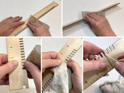

Finishing the wood

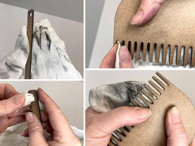

I wasn't really concerned about splinters on the comb and needle that I cut from hardboard, but the amount of soot was unbelievable! And because hardboard is literally compressed cardboard, you can't really wet it too much. I sanded the edges slightly to remove some of the rips from the paper when the laser didn't quite cut through in some areas (after NINE passes!!!). Then, instead of wetting my cloth and wringing it, I wet my hands and dried them on the cloth so it wasn't too damp, then I wiped down all the edges thoroughly several times. To get into the hole in the needle and between the tines on the comb, I twisted and folded the cloth and flossed those areas, pulling the cloth up and down in all directions to make sure I got as much soot as I could.
For the wood, I used my wet/dry 220 grit sandpaper and sanded the charred areas just so it was pretty and then folded the sandpaper over the outer edges to round them off and make them smooth. Then, just like the comb tines, I folded my sandpaper and went in between each notch on the top and bottom pieces to smooth those edges. I was able to use my thumb nail to slide the sandpaper into those grooves to round off the upper and lower sides but it did some damage on my nail. I don't recommend it if you care about the look of your nails. The rulers I engraved on these pieces came in really handy already because after doing 10 or so notches, they all start to look the same and I was loosing count of where I was. It was easier to just make note that I was at the 4" mark and then 4-1/2" and so on.
When I was done sanding, I wiped away the sawdust with my cloth and cut a short piece of my warp string to run between the notches to make sure it didn't snag in any of them.
If you are using a harder wood, you could start with a rotary sander for the outer edges and then move to 220 grit sandpaper if you want your edges really rounded. I didn't want to risk breaking my basswood pieces so I decided against that. But because the wood is so soft, the edges were easily smoothed without much effort.
For the smaller connecting feet pieces, I laid the sandpaper down flat on my table and just slid those pieces around on top rather than try to sand them while holding them. It was much easier and faster.
Then I grabbed my two hanging rod pieces and all my connecting feet pieces and glued them. I used binder clips to hold them together while the glue dried. NOTE: When using the binder clips, the pieces may slide, so make sure you nudge them back into place before the glue becomes permanent or they won't work.
When they were ready, I glued rubber bumpers to the bottoms of each of the feet. The rubber bumpers I had on hand are nearly 12mm in diameter, so I cut them in half and glued both halves to the bottom of each foot.
If you have to do this, DO NOT USE YOUR YARN SCISSORS FOR THIS! My mother will yell at you. This is just a common, sometimes unspoken rule in the fiber art world that was taught to me by my mother when I was still mostly a toddler. You have your fabric (or yarn in this case) scissors and paper scissors and you NEVER EVER use your fabric scissors for anything other than cutting fabric, thread, yarn and the like. Likewise, your paper (or in this case rubber) scissors are not sharp enough to cut fabric or yarn and will tear through it rather than make a nice, clean cut.
If you don't have rubber bumpers, you could use anything that creates friction on your surface that won't ruin it. Silicone caulk, electrical tape, or take painter's tape and roll a small section into a backwards loop so that the sticky side is out and stick that to the bottom of the feet and to the table. You'll want to do this right before you warp the loom, however.
Next, I used my damp cloth to wipe away soot and sawdust left on the cut edges. It wasn't as bad as the hardboard, but still worth doing.
Then you could finish every piece with 2 coats of clear acrylic sealer with a light sanding between coats. Make sure to lightly sand between the notches and comb tines, too, because the sealer tends to be a tad rough if not sanded. This not only protects the wood but also the yarn. I opted not to do this at this time because I was eager to get started. I promised myself I would eventually.
However, because I know sealer also keeps the soot in place in case any is left over, I cut another piece of warp string and ran it between all the tines on the comb and the notches on the top and bottom pieces of the loom just to be sure my art won't be tarnished.
Put your loom together
OK, this really is the easy part. Choose the length you want and use the connecting feet to attach the sides to the top and bottom at the corners.
For me, however, things got a little shaky because my basswood is actually 2.8mm and not 3mm like the hardboard. I had measured it, but didn't want to go back and change all files in Illustrator at the time, so I decided I would just glue the whole thing together after I cut it.
It was a good thing too, because I realized I should have added extra feet at the corners to keep the loom square. I did that in the design I'm selling on Etsy. Before I started gluing the loom, it kept skewing to an angled parallelogram instead of a square.

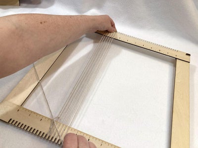

Step 5: Warp the Loom
What is warp string made of?
The most important part of the warp (at least for beginner weavers) is that it doesn't stretch. Apparently there are times when you do want it to stretch, but I'm not there yet skill-wise.
This means you can use the cotton cord I suggested in the supplies list (I got it at the Dollar Tree), or hemp cord, jute, that green gardening twine you get for tying up your tomato branches that start to sag, and really anything that is thin enough to fit inside the notches at the top and bottom of the loom, strong enough to handle constant tugging and pulling without breaking, and soft enough that you don't hate working with it. As long as it's not stretchy.
Before we can warp
Before I started this project, my plan was to just wing the design, but now that I've educated myself much more on weaving, I realized that's not the best idea. Before you can even warp your loom, you need to know if you are doing a super detailed piece that might require double warping. There are also some really thick fibers you can use to add texture that would require you to warp an even number that divided by 2 is an odd number. And, most importantly, you need to know how wide your project will be to make sure you warp the correct number of strings to get to that width.
And, as I was watching videos on different designs I could do, I realized I need to know which of my many balls of yarn I'm going to use because some are thin and might require double warping and some are really chunky which would allow me plenty of detail with just a single warp. After my buying spree, I ended up with a lot of different kinds of yarn. I needed enough of the same thickness to complete this piece with enough of a variety of colors to create something interesting.
So, before I chose a warp sett (with two T's — that's the technical term), I pulled out all my yarn and determined the best choice was some chunky, solid color yarn that I bought in four colors. They are bright colors, so this will be a bold, modern tapestry.
This means I could just single warp my loom. And because I felt confident in doing squares and rectangles (I have high hopes), I decided to do something similar to Piet Mondrian's art but more neon colored. And I looked at a ruler and decided 6" is plenty wide. Eight inches looked a bit intimidating to me.
Here we go!

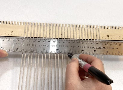

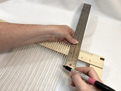

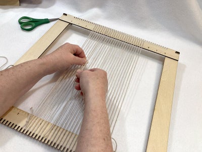

I decided it would be easiest to weave with the tapestry in the center of my loom. That means I will start at the 3" mark and work toward the 9" mark.
I set my iPad up off to the side of my loom, found the video on warping, took a deep breath, and tied a knot at the end of my warp string. For some reason, I was really nervous.
Anyway, I tied the knot, put it over the notch just under (and to the right of) the 3" mark, then pulled it up. Immediately I wondered, do I put the loop around the notch to the right or the left of the 3" mark at the top? The marks are directly above the spaces between the notches not the notches themselves, so I didn't honestly know which would be the correct notch. In Jenell's video she actually counted the notches (she doesn't have a ruler on her loom) and put it on the same notch on both ends, so I counted the notches up to where my knot was (13 of them) and went to the thirteenth notch on the top and looped around that one. Then I brought the string down. I remembered that Jenell strung the first downward warp over the loop created by the knot, so I went back to the video to watch carefully, and yes, you are putting it over the loop because technically you put your first string on the left side of that loop.
The next steps were easy. However, just to be sure I was creating enough tension, I strummed the warp strings I had already placed and they seemed super loose. I could touch the table and still had some slack. So, before I went any further, I tightened those up by pulling down on the up strings and up on the down strings. Then I tried to keep an even tension as I warped my way toward the 9" mark. To create an even number of warp strings, you will end at the bottom just as you started at the bottom.
When I got to the end, instead of tying a knot like Jenell suggested, I wrapped the cord around a couple notches a couple times firmly and went back to check the tension on my warp. I did this because of my earlier extremely loose tension. I figured I could fix it now rather than after I tied the knot. I saw someone else do it this way on another video and it made more sense to me as an extreme beginner. I found that I, again, made the tension so very loose (you can see how much slack I have in the string in the third photo above).
After making the tension what seemed to me to be correct (I honestly don't know but I'm going with gut feelings on this one), I tied the knot. But then I divorced the knot because I made that last warp string way too loose in tying the knot. I tried again and was happier with my second attempt.

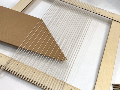

Step 6: Create a Base to Beat Down On

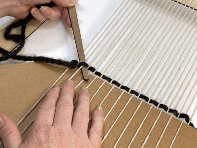

Before doing the twining, I needed to construct a piece of card stock to be wide enough to fit through the warp and sit on the edges of the loom. This helps give you an edge to flatten your woven yarn against as you go. You'll weave, then use your comb to beat the yarn down flat against the previous line you wove. The card stock gives you a sturdier edge to beat down on and helps leave you enough warp string at the bottom of your work that you'll use to tie off and keep everything in place after you pull it off your loom.
Since I decided to do a 6" tapestry instead of 8", I needed to make sure my card stock went high enough. The warp left over at the top is what I would be using to hang on my hanging rod. I needed enough to be able to make a lark's head knot over the hanging rod but not too much that there would be a whole lot of empty space between the rod and the tapestry. I took some extra warp string, looped it around and tied an overhand knot at the base so that my loop was 3.5" long. Then I did the lark's head knot like Jenell gives directions on in this video and looped it around my hanging rod. There was way too much string left over, so I measured how much I thought I needed to remove (around 3/4") and created another loop 2.75" long. That looked good to me (see second photo above).
So now I knew my card stock on the bottom needed to be 5.25 inches tall. That's the length of the warp strings (14.25") minus the warp I needed left over at top (2.75") minus my tapestry height (6.25"). SIDE NOTE: I accidentally warped 6.25" wide instead of 6" wide, so I'm going to attempt 6.25" tall for the tapestry.
I had a 12" x 12" piece of chipboard that wasn't too thick but obviously wouldn't span the length of my loom. But if I turned it at a 45-degree angle, the measurement between the two corners was almost 17" long. When I found the center of that length and measured up 5.25", the distance between the sides was almost 7" which is more than the 6.25" of my tapestry. I just needed the bottom of this piece to rest on the sides of the loom but the top would be fine as long as it was wider than the tapestry (I hoped). So I measured down a half inch from opposite corners to give myself a little extra and drew a straight line between those dots with my L-square. Then I turned the chipboard 90-degrees and drew a straight line between the opposite set of corners to find my perpendicular middle line. I measured up that line 5.25" (the height I need the cardstock) and made a mark. Then I made similar marks 5.25" from my original line on either side so I could create a straight line that will be what I'm beating my comb against. Then I cut out that whole shape.
If you don't have a long piece of cardboard you can use (like a family-sized cereal box you can cut up), you can cut two pieces of letter-sized card stock the height you need and tape them together to make a width that goes all the way across your loom.
Next, I wove the whole thing through my warp using plain weave (just over and under every warp string), centered it so the edges were on top of the sides of the loom, and pushed it to the bottom snugly.
LIGHT BULB MOMENT: I realized after weaving this chipboard in that the vertical length of my tapestry is not as fixed as I thought earlier. If I want to do a shorter length like I did for this project, I can just add more height to the cardboard insert at the bottom. Also, I learned after watching another video on hanging the tapestry, that the warp strings at the top can just be cut and you can use other methods to hang the tapestry. So if you want to use the same cardboard insert for longer looms but still do a shorter tapestry, you can.

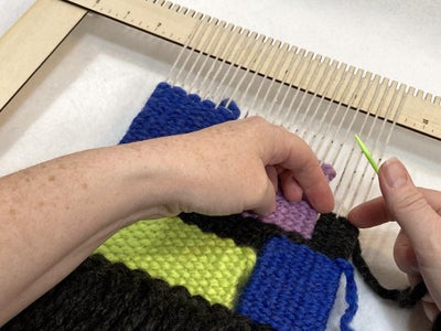

Step 7: Twining and Some Plain Weave
A twining stitch is a foundation stitch that helps keep your warp strings in place and helps keep your tapestry in place when you go to remove it from the loom. It seems many weavers like to use this one for the tops and bottoms of their tapestries, so it must be important.
Choosing the color
Before I did my twining stitch, I needed to decide what my actual tapestry was going to look like color-wise. Because the twining stitch and the fringe are a part of the design, I needed to decide what color yarn I will use. In most of the videos I watched, people tended toward making a white or off-white fringe and then focusing on color within the tapestry itself. But there were some where people worked the color from their tapestry into the fringe. Plus, Mondrian art has thick black outlines. I had already decided that my twining stitch would probably be made from my black yarn to mimic that look. But did a white fringe or black fringe make more sense? Or do I want to attempt to add more colors into my fringe? Would more colors be gaudy and take away from the art within the tapestry itself? Well, for me, the best way to know is to draw up a quick design in Illustrator and try out a few options to see what I like. That way I'm not undoing more than doing when it comes to the actual weaving (foreshadowing maybe?).
The colors of yarn I have are black, lime green, lavender, and royal blue. I also have white but it's a different yarn type and thickness. Thicker for fringe apparently is the go-to for most weavers but it doesn't have to be that way.
In Illustrator, I created a 6" x 6" document and drew some rectangles at random to create that Mondrian look. Then I drew thick black lines on top of those. Then I just started coloring in the shapes with the colors of yarn I have until I found a color balance I liked.
Then I drew a bunch of 8" long V's at the bottom (more on the length later) to represent the fringe. I tried black, white, and mixed colors. I immediately hated the white fringe because it was too stark. I didn't hate the multi-colored fringe, but I felt like solid black fringe seemed more dignified and made the actual tapestry stand out more.

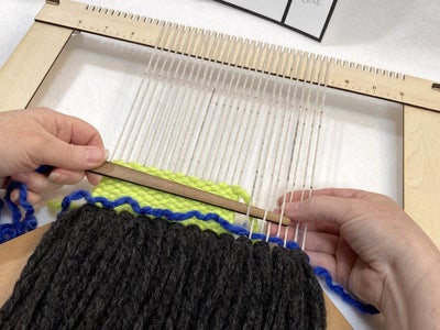

Twining
With the color decided, I set my iPad up beside my loom and started watching the twining video again.

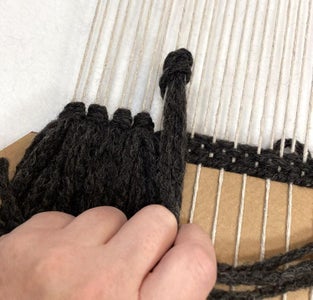

I pulled out my black yarn and measured five widths of my warp plus some extra for threading into the needle and weaving into the back of the tapestry once it's done.
HINT: It's easier to thread the tapestry needle (and the yarn needle later) if you fold the yarn over and tuck the folded part into the eye of the needle, using your fingernail, another needle, blunt end of scissors or anything firm that will fit into the eye and help shove the yarn through.

Draw my design on the warp
When I drew my design in Illustrator before, I hadn't taken into account that the twining stitch, first few rows of plain weave, and fringe would take nearly an inch of space at the bottom. Lesson learned.
I knew I'd still needed that 2.75" of warp cord at the top to wrap around my hanging rod, so I took a ruler and measured 2-5/8" down from the top (I was hoping the extra cord behind the notches would give me just a little more space to work with). I marked that measurement on both end warp strings and drew a line with my marker across the top so I'll know where to stop weaving. And now I know to make room for the twining stitch at the top too.
So, at this point my tapestry would be 6.25" wide by 5-5/8" tall with 8" of fringe below (minus what would be trimmed so they are even). Could still work.
I printed out my design in black and white, wrote where the colors go in each block, then freehanded the design in the space I have between my fringe and the line at the top with a black marker, using a ruler to make sure my lines were at least straight. I used black because I knew I'd be covering those marks with the black yarn.

After that, I completed the top left blue box, stopping just short of the black line at the top to make sure I had room for the twining stitch.
Then I started the lavender box but noticed that when I first started, the warp cords were showing through more than in other areas. I realized I had started going under the first warp cord on the right and that's how the black yarn underneath was too. When I pulled my yarn out and did the opposite of the black yarn, going over where the black yarn was going under, it covered up the warp cords better.
As I worked my way up, I realized if I went all the way to where I drew the line for it to stop, I would only be leaving space for two or three rows for the lime green box on the top right. That's because I would need to stop the lime green box at the same height as the royal blue box on the left to leave room for the twining stitch across the whole top. So, I made the lavender box slightly shorter than my drawing and hoped the black marks on the warp cords get covered by black yarn. At least I didn't have to pull out more yarn again.
Before I started the vertical black box on the right side of the lavender box, I made sure I knew what path I needed to take to get two rows of black above the lavender box. This time, it wasn't so difficult to figure out because I wasn't having to go in a Z formation. But, I kept seeing the warp cord showing between the blue box on the right and the black yarn above it. After what happened when I started the lavender box, I realized why. The black yarn and the blue yarn were woven the same instead of opposite each other. So instead of starting at the bottom right to begin my vertical black box, I threaded my yarn needle — since it's smaller — and went from underneath my tapestry to pull the yarn up at the left side of the blue box and pull it over the warp cord that was showing there. Then I wove in and out over those cords to cover them up. I then started weaving my way up the right side to fill in the vertical black box. I continued to use my yarn needle instead of the tapestry needle because it was such a tight space there. I also packed the yarn down with my fingers instead of the comb for the same reason.
When I got up to the top of the lavender box, I made sure my weave would be opposite of the top row of the lavender box, packed down the black yarn a little more, then worked all the way to the left side of the lavender box, turned around, and wove to the far right again. Then I cut the yarn leaving a tail to weave into the back later.
Finally, I filled in the short green box on the top right, making sure my yarn was weaving the opposite of the black row below. I started from the left to fill in the box so that I wouldn't have two tails to tuck in right next to each other on the right side. I ended up with two tails right next to each other on the left side of the box instead.
