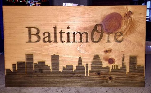

The Baltimore skyline was created for a silent auction for a coworker of my daughter who was shot early Christmas morning. He did not have insurance and was in the hospital for 3 weeks. My daughter came up with the design and I burned it on a pine board and stained it. This sign raised $100 at the auction!
