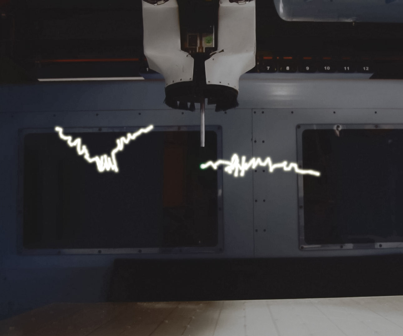

After tuning the code and changing to a more powerful laser I decided to give it another try. Turn the lights off and the let the camera role.
As you can see there was significant progress. The main problem however is the lack of resolution one can get using stander servos with the arduino servo.h. Another problem I was encountering was the the fact that the entire setup was pretty slow and if I tried to go faster the servos would go crazy...
