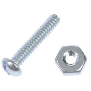

Screws: 6-32, 3/4" x 8 and matching nuts x 8 $2.25
