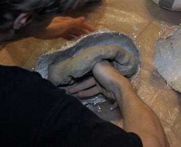

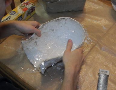

Step 7: Adding Clay to the Molds
First, for easy release of the clay from your molds, lay some plastic wrap into the molds. Then, take your clay and cut out some large pieces. Something that can help with this is floral wire; pull it out tightly between your hands and drag it through the clay brick to slice a large slab. Lay this down into the molds, and fill them completely with about 3/4" of clay. Press the clay all the way into the molds, with a lot of pressure, to ensure you're filling the details of the molds.
Put your foam head into one of the molds. Position it properly, centered in the mold, and press the other mold on the other side, squeezing them together until the plaster mold edges line up. You'll have to add and remove some clay in some areas to get it to fit perfectly.

Step 8: Finish the Clay Head
Do your best to make sure that the clay in the molds fills all the empty space and is tight against the foam head. If you have a big hollow area between your clay and your foam head, the clay might collapse when sculpting, which isn't good.
Once the clay is in the molds, and pressed tightly against the foam head, you can then pull the plaster molds off. The plastic wrap will stick to the clay; peel it off. Add more clay to fill the seam where the two halves meet together, and smooth everything out, and you should then have a clay copy of your head, ready for sculpting!
