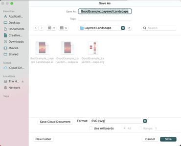

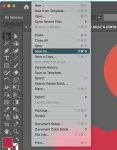

In Illustrator, press File > Save as. . .
Save the drawing as an SVG file (this is the vectorfile type that the Glowforge needs)
Pro Tip:
Take some time in Illustrator to organize your layers. This can be helpful to you as you manipulate the drawing in the Glowforge app.
In particular, separate each vector into one of 3 layers: CUT, SCORE, and ETCH. You can even color each layer in different ways to eunsure your project will come out right.
Check out the attached PDF for more.

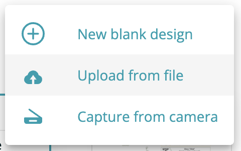

Go to app.glowforge.com and log into your account.
Press "Create" to make a new design and upload your SVG file.

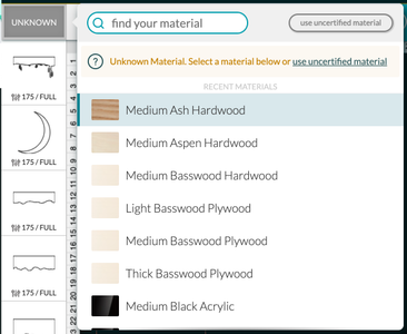

Step 4: Chage the Laser Settings

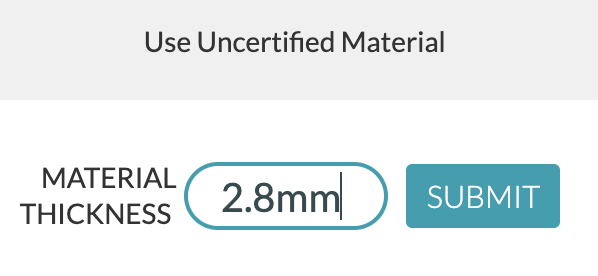

First, set the material thickness to 2.8mm.
Select the vector shape in your layers panel on the left side of your screen. Start with each shape to be CUT.

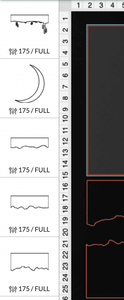

Select the Manual Settings option and type in the Speed and Power settings for a CUT operation.
  • CUT Speed : 175
  • CUT Power : Full
Repeat this for the SCORE and ETCH operations, using the image above with settings.

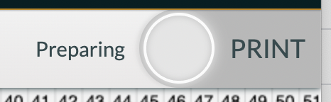

Press the print button on your Glowfore app and wait for the machine to prepare the cut.
Once the button on the Glowforge Machine glows white, you are ready to cut. Press the button and watch the magic happen.
