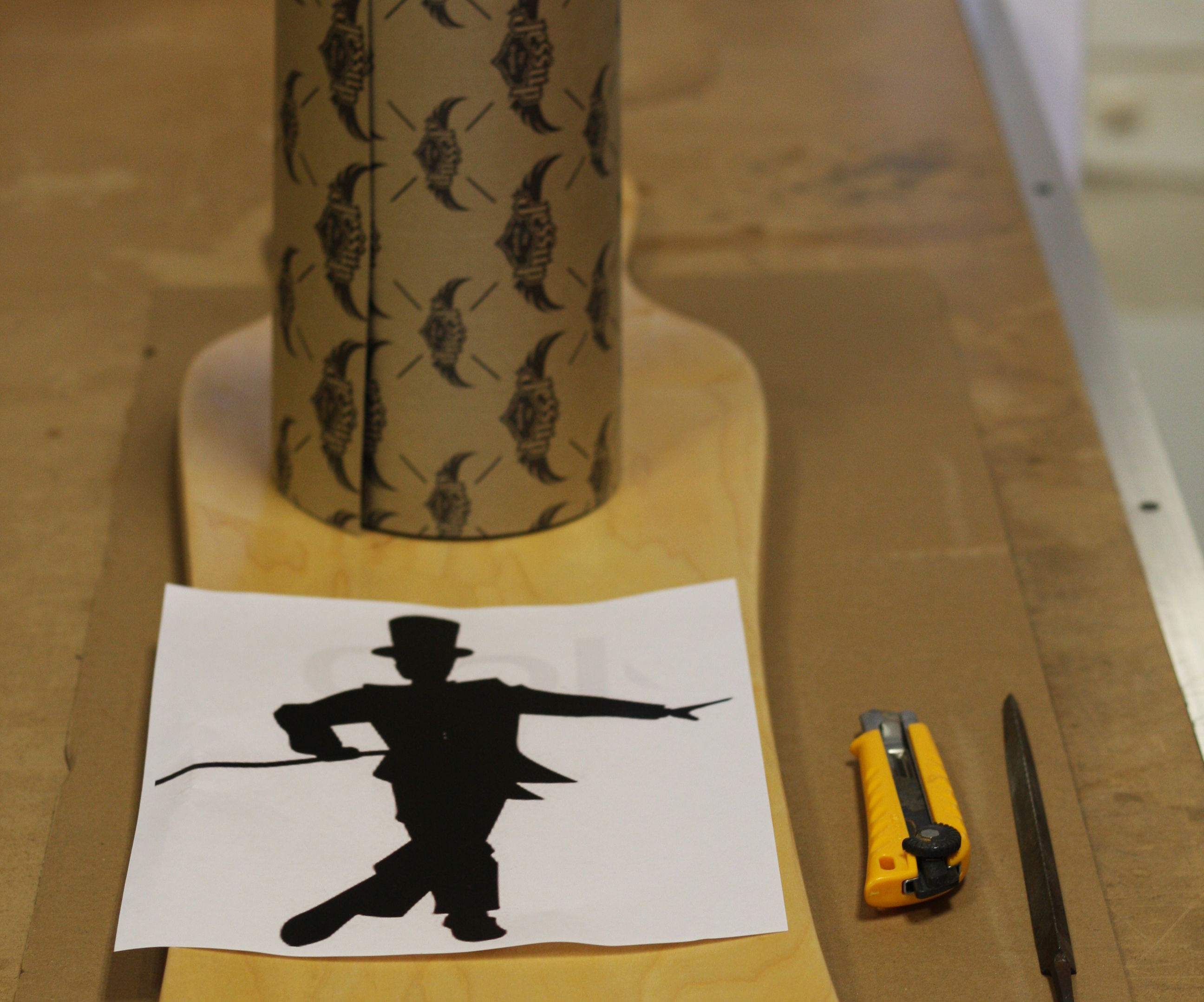

Step 9: Ride the Board!
There you have it - a professional quality skateboard deck, ready to grip and rip!
The great thing about building a deck using a one-sided foam mold in a Thin Air Press vacuum bag is that you can easily tweak your shape and try it again. Say you try your board, or get feedback from a rider that the kick tail isn't steep enough to do a certain trick. You can simply shave off a bit more foam from your mold and press the deck again. Even if you have to reshape the entire foam mold, it is much easier than remaking the two-sided concrete mold that is generally used in costly hydraulic presses. This makes the Thin Air Press vacuum bag process ideal for prototyping new deck shapes and styles.
