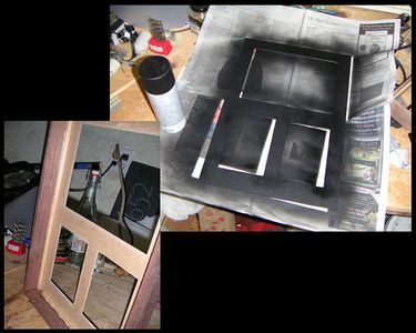

Step 2: Buidl the Frame
I went ahead and build the frame, very simple and straight forward as shown in the pictures. After my first attempt I cut the frame in half to fit the dimensions of the laptop. I used some pieces of cedar for the frame and Mdf of 1/8" for front.
I also painted the front with black matte paint.

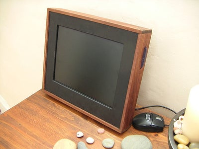

Step 3: Reconfiguration
I was mentioning that the original idea didn't went well, so I cut the original frame to fit a better configuration. Basically a custom made frame for the size of the lcd screen.
I disassemble the laptop, without getting into the electronics and with a little of intervention I was able to disconnect the hinges of the lcd screen and place it back to back with the rest of the laptop (back of the lcd screen against the keyboard/controllers) and reconnect the video and power cable, luckily for me the pressario 305 has a dock that comes off (where the floppy and cd-drive goes) I took it out and the thickness of the laptop back to back was reduced.

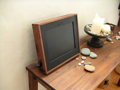

Step 4: Final Product
Looks much better doesn't?. The Laptop is a Presario 305, 64mb ram, 8Gb of memory and Win Xp pro, I can load pictures over the network (wi-fi), or via Usb, and placed them in the screensaver or use irfanwiew or windows slide show to view the pics, or I can go online and use flicker too in slideshow mode. The machine is very slow and takes a while to start and/ or connect to the network, but once is running works great.
