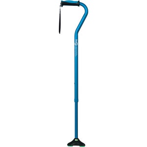

3 - An adjustable aluminum cane, 3/4" tube (you can find used ones at goodwill store for very little $.)
4 - A wide base cane tip (I used the Hugo Mobility Quadpod Ultra Stable Cane Tip with Compact Quad Design)

Step 2: Cut Your Cane
Use the hacksaw to cut the hook handle from the rest of the cane. You want to make sure that you have a straight tube.
As an option, if you have a metal file, you may wish to file down any burrs and jagged edges from the cut area. Since the cut area is tucked up under the seat, I did not do this myself.

Step 4: Tip Your Cane (optional)
Remove the old cane tip, and install the new and improved one. If you choose to use the tip that came with the cane, be wary as it may tear depending on your weight. I find the Quadpod very stable and it grips well.
