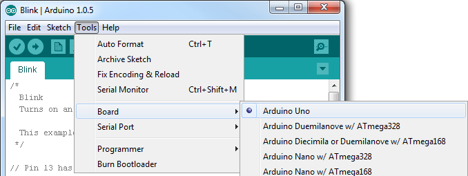

Step 6: SETUP
1.Install the arduino IDE software.(free software)
2.plug in your arduino board and select the correct port and variety.
note:for me the port number is com23 yours may vary.
Refer images!

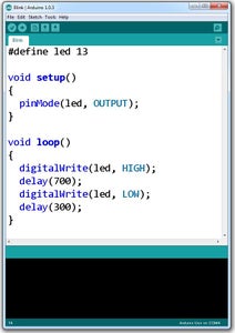

Step 7: Your First Project-LED Blink
In this project you are going to make an led to blink.
one second ON state,one second OFF state.
Hardware
make the connection as shown in the figure.
Software
upload the coding shown in the image.
As soon as the coding is uploaded the led starts blinking.
note:
void setup() -section executes only once.
void loop()-executes repeatedly till the power remains on.

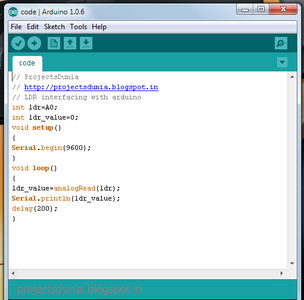

Step 10: Applied Serial Communication
In this session we will be getting the output value from an LDR -light dependent resistor and displaying it in the serial monitor.
refer the images for hardware connections and coding!
now interrupt the sensor value by disturbing light falling on the sensor and see the changes in the values!
