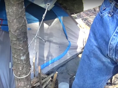

Have a close look at the knot before trying to learn it. We see in the picture two Taut Line Hitches, one near the tarp and another connecting the tarp to the tree. We'll untie the one nearest the tree and retie it.

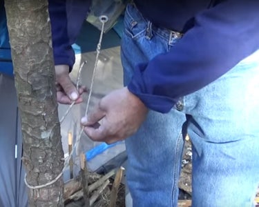

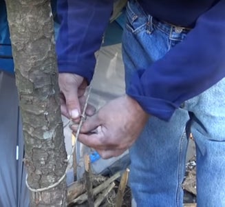

Wrap the cord around the tree and you'll see one part of the cord is straight and the other end is the one you can twist around the straight cord. Take it slow and let your eye follow the cord as it forms the knot in the pictures and it won't be confusing, it will be simple. It will probably help if you watch the video I made, (these pics are screen captures from that video), and its easy to learn the Taut Line Hitch if you can see it tied while I tell you what I'm doing.

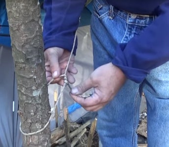

Wrap the end of the cord around the straight part of the cord between the tree and where the cords cross. Do this twice so you end up with 2 loops around the straight cord side by side and nearest the tree.

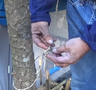

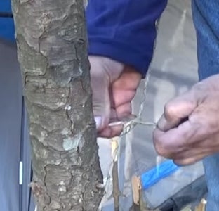

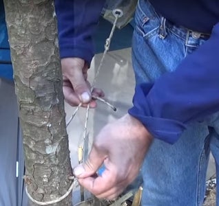

Now wrap the cord around the straight cord again, but this time do it on the opposite side of where the cords cross. This will give you two loops near the tree and one loop closer to the tarp. Then snug everything up. (It wasn't easy the first time you tied your shoelaces but I guess you're pretty good at it now, so be patient and practice the Taut Line Hitch and you'll see how easy it really is.)
To loosen or tighten a Taut Line Hitch, hold the straight line, grab the knot and then slide it along the straight line. Unless you're holding the straight line still, the knot won't move. Very cool!
