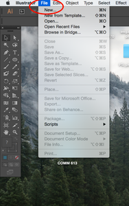

Step 1: Create New Document
-“File” > Select “New…” -Pick size of choice (I am doing a standard letter size, 8.5x11 inches).
