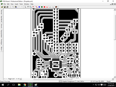

Step 2: PCB Design
This is my PCB design, SMD devices was used to minimize space.
The software that was used PCB Wizard, adding the library for resistors SMD and PIC SMD.

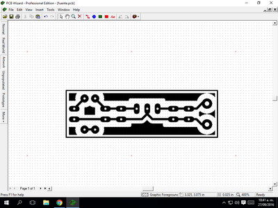

So too the PCB voltage regulator was battery 9v design.
I leave the files of the two PCB.

On the main PCB is to left two buttons to use, and a ICSP connector for programming PIC.

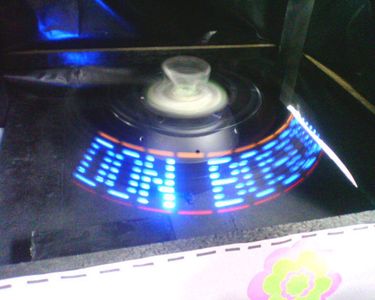

Step 6: Final Result
You can watch the video with final results.
For those who want to experience, you can create text, propeller clock and drawings is a matter of imagination.
