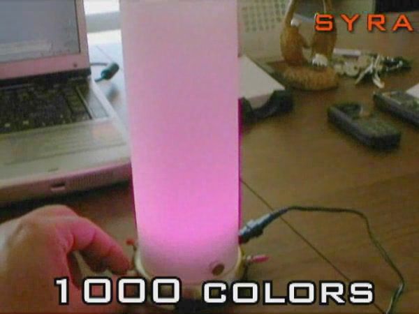

Introduction: Led Dimmer 2 Channels
This is Attiny13 2 channels dimmer with 5 program modes and speed control:
1. Dim between 2 channels
2. Dim 2 channels together
3. Blink mode 1
4. Blink mode 2
5.Blink mode 3
3. Blink mode 1
4. Blink mode 2
5.Blink mode 3
