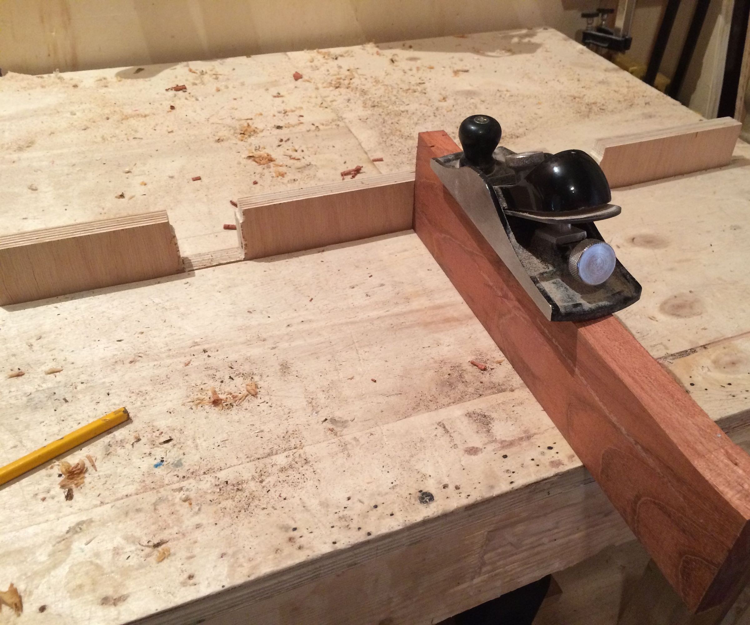

Step 1: Materials You'll Need
I did not have a thick enough board so I cut a board in half and glued the two pieces together after making the surface of both pieces flat and clean.
I think a 5-6 cm thick is enough.
The length depends on your Work Bench and the width should be about 15 cm.
You need also a good strong Lead Screw.
I took a lead screw off from a broken work bench but these can also be found in web shops such as Amazon.
