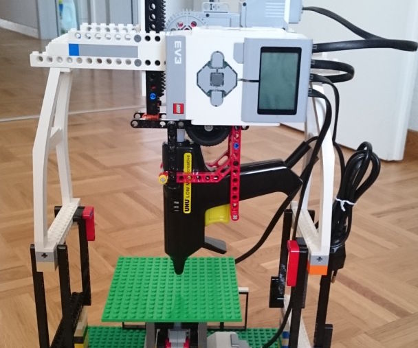

Hi! My name's William and this is my first time on instructable.com
My first project is this Lego Mindstorms 3D printer. I've already built a prototype before this version, but the results were well...mediocre. This is the 2.0 version. It's more precise, more efficient and the printed objects are better than in the previous version, although far from perfection.
Step 1: Step 1: Building the X and Y Axis
You'll need:
- 2 large (16x32) lego plates
- About 30 Lego gear racks (4x1)
- Long and thin Lego bricks
I think that the image explains pretty well how to build the X and Y axis so I hope you won't need any further information for this step.
Step 2: Step 2: the Y Axis Moving Platform
You'll need:
1 square Lego plate (16x16)
Several long Lego Technic bricks with holes (Number depends on the size)
Some Lego pins
2 large Lego gears
2 small Lego gears
Step 3: Step 3: the X Axis Crane
You'll need:
Lots of Lego blocks
A 16x12 Lego plate (or a few smaller plates put together)
Those crane Lego parts (Found in the old "Lego Mars Mission" sets or some Lego train sets)
Some Lego Technic parts with holes
Step 4: Step 4: the X Axis Crane Motor
Similar to the Y axis platform motor, the X axis motor needs to be wider, in order to stabilize the crane.
Once built, you'll only need to attach the X motor beneath the crane.
Step 5: Step 5: the Z Axis Motor
You'll need:
1 Large EV3 motor
some twine
2 Lego tyres
2 Medium Lego gears
When finished, just attach the motor to the cranes' front arms.
Step 6: Step 6: the Extruder
NOTE: attache the extruder to the Z axis motor ONLY after step 7
You'll need:
A glue gun (with glue stick)
A medium EV3 motor
some twine
A large Lego tyre
A small Lego wheel hub
Step 7: Step 7: Balancing the Crane
Try to find a counterweight for the back arms of your crane in order to balance the crane. Try to find a balance between the heavy glue gun extruder and the counterweight.
Step 8: Step 8: the Brick
Attach the EV3 brick to the bottom of the crane platform.
Step 9: Step 9:
Your printer should look something like this now
Step 10: Step 10: Programming the Printer
The image shows a program that I used to print a square.
Depending on the glue gun you used, the extruders' motors' speed will vary form program to program.

7 years ago on Introduction
How did you make the glue come out?
Reply 7 years ago on Introduction
With the extruder. The motor-powered wheel pushes the glue-stick into the gun, which fuses the stick and lets it come out in a liquid form.
Yeah, I tried that but its not working. Can you give me some tips on how to get the glue out?
Ah! I see waht you're saying. I had that problem too. The problem might be that your glue stick fits too tightly between the two wheels; in this case the motor-powered wheel spins and spins without pushing the glue down.
I went through several extruder designs until I found one that works (In the picture). If that still doesn't help, you should consider using another glue stick (since they come in many shapes) or maybe even another glue gun.
I hope my advice was helpful.

7 years ago
I recommend lowering the extrusion rate in corners and fixing the jitter it has when it starts on the back edge (it wiggles too much)
Awesome idea hope you keep perfecting it
True, I hope to make a better version within the next two months. Thanks for your support :)
7 years ago
awesome! would love to see some demonstrations. also why not use the ev3 brain as counterweight? I find mindstorm brains to be very heavy with all the batteries.
That would be very clever. Haven't thought of it. Thank you very much!
