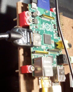

(1) Place the Lego standoffs on the mounting surface in a pattern that supports the edges of the circuit board. Find places on the circuit board where no components, lands, or traces exist.
Note and Caution: It is usually possible to find component and circuit free locations near the edges of circuit boards, but if needed, the standoffs can be installed over circuit traces but NOT COMPONENTS.
(2) Set the circuit board on the standoffs so that the edges of the board are butted up against the sides of the Lego brick snap posts and not on top of them. Move the standoffs around and use as many as are needed to firmly support the circuit board (Figure 3).

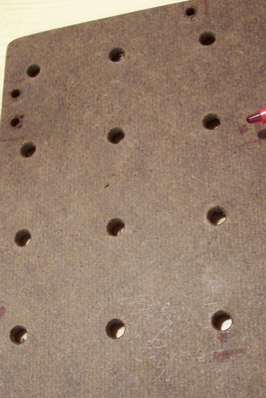

(3) Use a pencil or marker to carefully mark two sides of the final location of each standoff (Figure 4).
(4) Using your best judgement, drill holes where your marks indicate the center of each standoff is located. Use a drill slightly bigger than 3 mm to allow some room for adjustment in the final position.
(5) Run a 3 mm machine screw with a washer made of nylon or other non-conductive material through the each standoff and install them on the mounting board. At least 4-5 threads should protrude on the underside of the mount.
(6) Attach washers (they don't have to be non-conductive) and nuts to the ends of each screw so the standoffs don't wiggle around too much but are not tight.
(7) Place the circuit board on the standoffs so that the edges of the circuit board are under the non-conductive washers and butted against the sides of the Lego snap posts. Notice that the standoffs use clamping action to secure the board in the space under the con-conducting washers.
(8) Gently tighten the screws and nuts until the circuit board is firmly fastened in place.
Caution: Do not over tighten the screws. If the screws are overtightened, it is possible that the Lego snap post will be damaged to the point where metal screw threads could come in contact with the circuit board.
That ought to do it (Figure 5).
