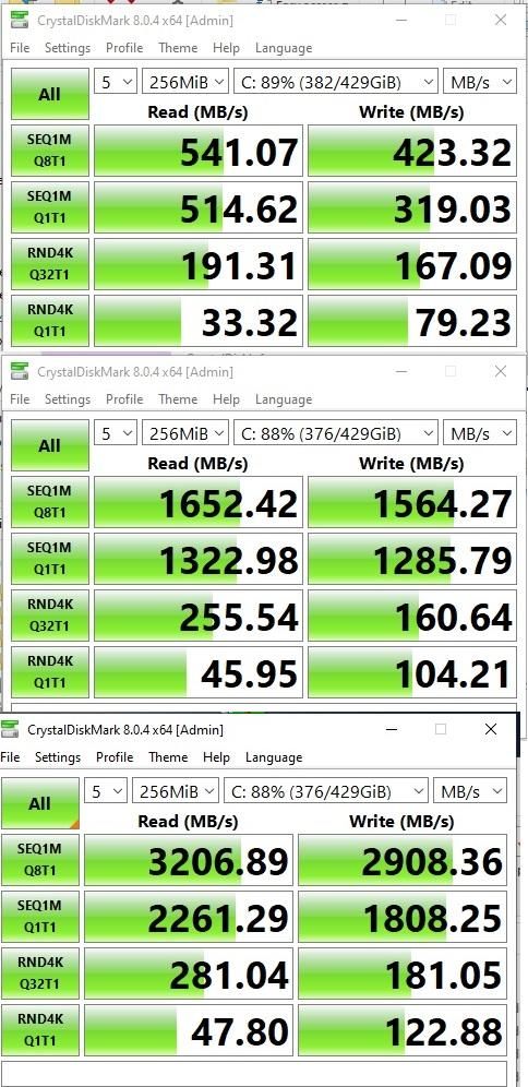

RUN A BENCHMARK TO SEE WHERE YOU SIT IN THE NVME SPEEDS AND TAKE NOTE SO YOU CAN RUN ANOTHER AFTER YOU CHANGE THE BIOS CAP
  • Nvme M.2 istallled in machine
  • crystal disk mark benchmarking to test speeds before and after the bios change

Check that setup variable C10 is now 03, Reboot and enjoy the full performance of your NVMe drive
RUN THE BENCHMARK AFTER REBOOT TO CAMPARE THE RESULTS FORM THE PREVIOUS BENCHMARK.
