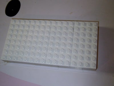

Step 2: The Base
Unless if you happen to have an 8x16 baseplate or have cut one to size, you will have to make to make one yourself. You'll need to stack two layers so that your baseplate stays together. You can use any combination of plates and/or bricks that you like but plates usually come in larger sizes so working with those can be easier.
I made a base out of a layer of tan bricks and white plates. I included the pictures to show how I assembled mine but this is just how I did it; as long as you end up with an 8x16 base you're good.

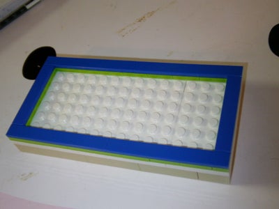

Step 3: The Frame
Construct an 8x16 frame using the 1x6 and 1x8 tiles and the 1x2 plates.
The 1x6 tiles go on the short side and two each of the 1x8s make up the top and bottom of the frame. Connect the tiles with the 1x2s then fill in with the rest. Attach on top of the baseplate.

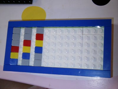

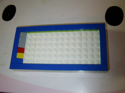

Step 4: The Rainbow
Now it's time to work on the rainbow image. Lay down the first row of cheese lopes against the left side of the frame as shown in the picture. All the cheese slopes need to be sloping the same direction (mine had the high end against the frame). Skip one row of studs and add the second row, making sure that the slope is going the same direction as the first row. Keep skipping and adding rows until all 7 rows of the rainbow are attached to the base, all slopes the same direction.

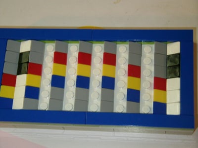

Step 5: The Heart
Attach the first row of the heart design between the first two rows of the rainbow design. Just make sure that the slope direction is the opposite of the rainbow direction.
It can get a little confusing when adding the second image to the model. Since the pattern is symmetrical, I added a row to the left and the right sides at the same time, as shown.

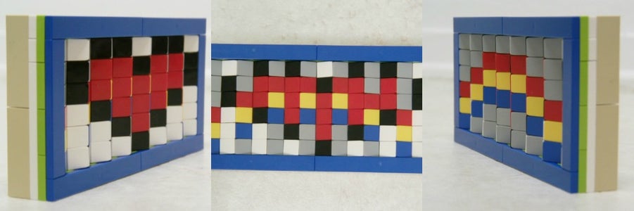

Step 6:
Turn the model to side to side to see the two images magically appear and disappear.
