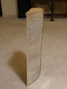

Step 8: Attach the Skin of the Wings
The round part of the wing and the back side (the side with the two ribs) is covered with some sort of skin. I chose to use aluminum flashing material that I had left over. You may have some other kind of material that might work.
My roll of flashing was 6 inches wide. I discovered that if I cut two pieces 6" x 21", I could cover the leading edge and the back of each wing. I was able to attach one piece of flashing from one rib to the other around the leading edge. I anchored each piece with a few metal screws. Some of these went into the ribs and others into the edge of the plywood end piece. Then I attached the second piece of flashing to the back part of the wing, They were screwed into the back ribs. This piece of flashing can overlap a little with the one going around the leading edge.
Do this for all three wings.
Now you are ready to attach the wings to the center axis.
