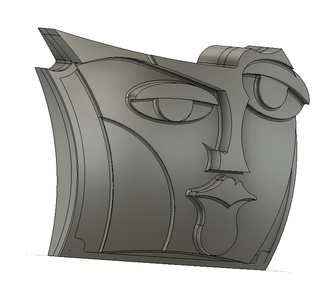

We now turn our attention to Front LH. You’ve got your 72mm thick blank ready? As before we need to do something with those four holes? Front LH needs to be machined on both sides. We’ll machine the backside first and then flip it, but when we flip it we need dowels protruding from the backside to glue down to the backboard to hold the piece secure whilst machining the front. At the same time we don’t want Fusion to see holes in the front or they’ll be avoided.
Turn Front 72mm blank LH on and Front LH off. Select front face CREATE - Create Sketch – CREATE – Project/Include – Project – Select Body symbol in popup – select outline of body – OK. Select 4 hole profiles, right click Extrude - Direction - Two Sides – Side 1 Distance -72mm – Side 2 – Distance -14mm - Operation – Join – OK.
Turn on Front LH, We need to turn bodies to face the backside. This is how the 72mm Front LH blank has to look sitting on the CNC table, it’ll match the drilling of 12mm Backboard LH. We need to create an XYZ reference point on the face of 72mm Front LH and the centre of the bottom LH dowel. In DESIGN select that face CREATE - Create Sketch – CREATE – Project/Include – Project – Select Body symbol in popup – select outline of body – OK. CREATE – Point and select it’s location. Finish Sketch.
Select MANUFACTURE – SETUP – New Setup. Select Stock tab of popup. Mode – From solid. Select Front 72mm blank LH. Select Setup tab For Model select Front LH and the four dowel bodies. Orientation – Select Z axis/plane – Z Axis select an edge – Flip X Axis – OK. Rename new Setup Front LH Rear face.
Select 3D – Adaptive Clearing.Tool tab = 12mm dia flat end mill (Use whatever you’ve got). Select Geometry tab. Unselect everything. Passes tab select Maximum Roughing Stepdown = 5mm.Stock to Leave = 5mm – OK . The toolpaths generated should avoid the dowels? ACTIONS – Simulate. Turn Stock on, Toolpath off. Watch and be sure it’s what is required?
Now we need to smooth this milling. Select 3D – Scallop. Change tool to 10mm Ballnose. On Geometry tick Rest Machining. On Passes tab select 1mm Stepover and Inside Out – OK. Right click Front LH Rear face in Setup. Click Simulate. If all’s good Post Process the Adaptive and Scallop.
Step 4: Front LH Front Machining
Now that the back face is done we can turn our attention to the good bit, milling Cubby’s face. At the moment her face has got 4 holes in it. We need to find where on the timeline that occurred and delete it? After doing that turn the second last sketch on where you placed a point on bottom LH dowel centre face side up, as well as Front LH and Front 72mm blank LH. Select MANUFACTURE – SETUP – New Setup. Select Stock tab of popup. Mode – From solid. Select Front 72mm blank LH. Select Setup tab. For Model select Front LH . Orientation – Select Z axis/plane – Z Axis select an edge – Flip Z axis - Flip X Axis – OK. Rename new Setup Front LH Front face.
Select 3D – Adaptive Clearing.Tool tab = 12mm dia flat end mill (Use whatever you’ve got) Select Geometry tab. Unselect everything. Passes tab select Maximum Roughing Stepdown = 5mm. Stock to Leave = 5mm – OK . The toolpaths generated should avoid the dowels? ACTIONS – Simulate. Turn Stock on, Toolpath off. Watch and be sure it’s what is required? Now we need to smooth this milling. Select 3D – Scallop. Change tool to 4mm Ballnose. On Geometry tab tick Rest Machining – Adjustment = Use as computed. On Passes tab select 1mm Stepover and Inside Out – OK. Right click Front LH Rear face in Setup. Click Simulate. If all’s good Post Process the Adaptive and Scallop.
