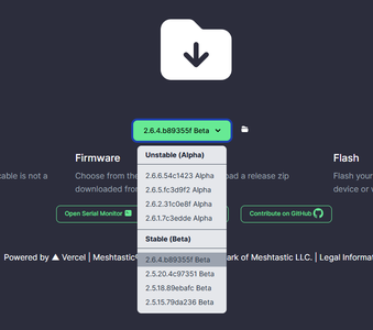

- Choose the firmware version:
- In the next drop-down menu, select the latest stable beta.
- Currently, it is version 2.6.4.
- Click the Flash button.

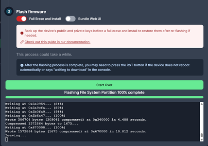

- In the pop-up window, toggle on Full Erase and Install.
- Click Erase Flash and Install to proceed.
- When another pop-up appears, select the correct port:
- Look for a USB JTAG device in the list. (If you have multiple devices in the list and are not sure which is the correct one, just unplug the USB, click on install and see which name disappears from the list)
- Select it and click Connect.
- Wait for the flashing process to complete:
- Do not unplug the device or turn off the computer during this step.
- Interrupting the process could permanently damage (brick) the T-Watch.
Once the flashing process finishes, you’ll see the message “Flashing File System Partition 100% Complete.” This confirms that the device is ready to unplug. Go ahead and disconnect the USB cable, toggle the internal switch to the ON position, and carefully place the battery back into its position. The T-Watch S3 should now boot into Meshtastic.
