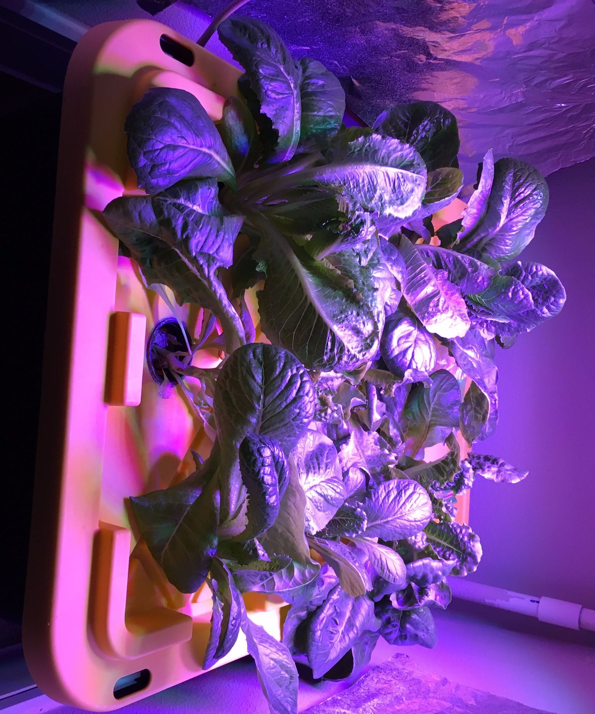

Step 1: Setting Up the Location
INSTRUCTIONS
- To utilize dead space, I chose to setup inside my A/C closet.
- When choosing a location for your project, keep in mind the following :
- Temperature should not change dramatically.
- Power Outlet closeby, but not too close where it could get wet from splashes.
- A place to clamp the light
- A way to close the area so that the light will not go everywhere
WHY IS THE LIGHT PINK?
- The light looks pink because it is a mixture of Violet-Blues and Orange-Reds LEDs.
- These lamps are commonly known as Full Spectrum Light.
- Reds are needed for Chlorophyll A (used in photosynthesis)
- Blues are needed for Chlorophyll B
- Greens are reflected by the plant
THE SHOPPING LIST
- Full spectrum Light Bulb with heat-sink - Amazon link
- Light Clamp - Amazon Link

OUTCOME
Hydroponics/Aeroponics works as people says. It is hard to get started because of the many factors to be aware of. Once you have everything setup correctly, DWC is very enjoyable
I am still far away from regrowing lettuce to the point where you can eat it. I did plant lettuce from seed on dirt and hydroponically on a Gold Peak plastic bottle using the Kratky Method. I'm still not sure if re-growing lettuce can be do.
TOMATOES
DWC became my new hobby. I moved away on from re-growing lettuce and now I enjoy growing tomatoes hydroponically on my balcony. I started growing them in from seeds and I saw the first tomato flower yesterday. Also, I was able to clone a tomato sucker in the aeroponics bucket!

It looks to me like your grow light is pretty high up. I would recommend placing it much closer to the plants to keep them from getting long and spindly as they try to grow closer to the light.
