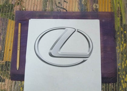

Step 3: Cut Out
Browse a car logo website for the Lexus logo. Print it out on a sheet of paper. Copy it onto your work piece. You can use either carbon paper or spray glue.
Cut out the logo itself. You can use a portable or power jigsaw, as well as a narrow band saw. It is very important to trace the logo’s contour exactly. Please, do not throw away the internal parts. Later you will use them as spacers when trimming the outer edge.
