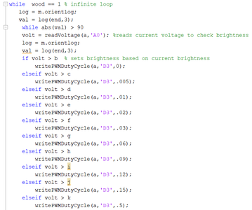

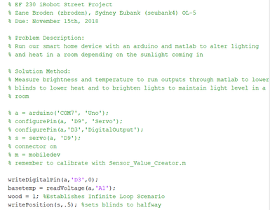

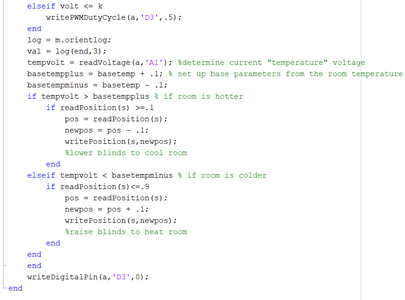

Step 5: Coding
The Code is shown in the images above

Once your 3D rod is attached to your servo, all the wiring is complete, and you've written the whole code, you have your own energy efficient lighting system!
