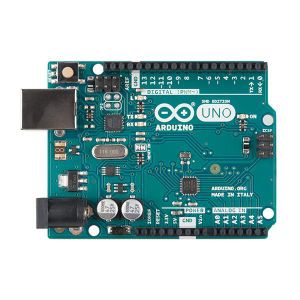

  • Arduino UNO or any other Arduino board

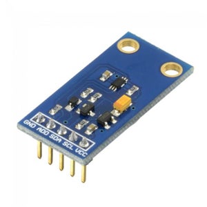

  • BH1750 Ambient Light Sensor (I2C)

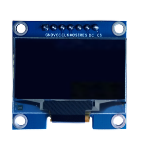

  • OLED Display

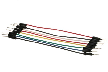

  • Jumper wires

  • Connect Light Sensor pin [SCL] to Arduino pin [SCL]
  • Connect Light Sensor pin [SDA] to Arduino pin [SDA]
  • Connect Light Sensor pin [VCC] to Arduino pin [5v]
  • Connect Light Sensor pin [GND] to Arduino pin [GND]
  • Connect OLED Display pin [SCL] to Arduino pin [SCL]
  • Connect OLED Display pin [SDA] to Arduino pin [SDA]
  • Connect OLED Display pin [VCC] to Arduino pin [5v]
  • Connect OLED Display pin [GND] to Arduino pin [GND]

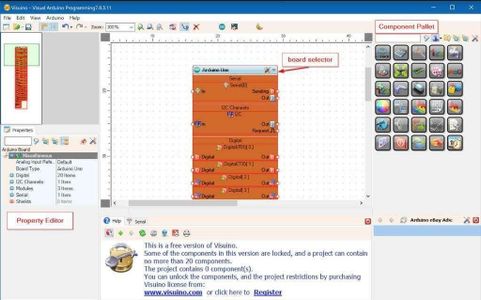

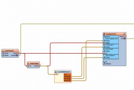

Step 3: Start Visuino, and Select the Arduino UNO Board Type
The Visuino: https://www.visuino.eu also needs to be installed. Download Free version or register for a Free Trial.
Start Visuino as shown in the first picture Click on the "Tools" button on the Arduino component (Picture 1) in Visuino When the dialog appears, select "Arduino UNO" as shown on Picture 2

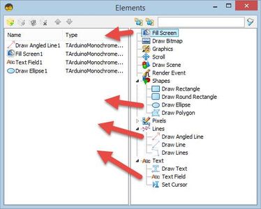

Double click on the DisplayOLED1 and in the Elements window:
  • drag "Draw Angled Line" to the left side and in the properties window set Angle to -10, End to 60, X to 64, Y to 63, select angle and click on the pin icon and select Float Sink pin
  • drag "Fill Screen" to the left side

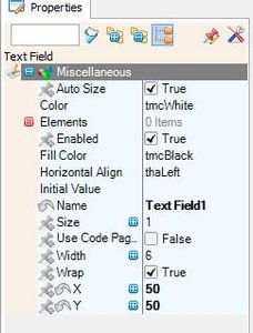

  • drag "Text Field" to the left side and in the properties window set X to 50 and Y to 50
  • drag "Draw Ellipse" to the left side and in the properties window set Height to 124, Width to 124 and Y to 20

Step 5: In Visuino Connect Components
  • Connect "LightSensor1" pin I2C Control to "Arduino" pin I2C In
  • Connect "DisplayOLED1" pin I2C Out to "Arduino" pin I2C In
  • Connect "LightSensor1" pin Out to "MapRange1" pin In
  • Connect "LightSensor1" pin Out to "DisplayOLED1" > Text Field1 pin In
  • Connect "MapRange1" pin Out to "DisplayOLED1" > Draw Angled Line1 pin Angle
  • Connect "MapRange1" pin Out to "ClockMultiSource1" pin In
  • Connect "ClockMultiSource1" pin[0] to "DisplayOLED1" > Fill Screen1 pin Clock
  • Connect "ClockMultiSource1" pin[1] to "DisplayOLED1" > Draw Ellipse1 pin Clock
  • Connect "ClockMultiSource1" pin[2] to "DisplayOLED1" > Draw Angled Line1 pin Clock
