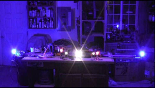

This is my submission for the Nostalgia Electronics Party Contest. I like playing with lights, lots of lights, so that's where I got my idea for this Instructable. What is a party without lighting? In this Instructable I will be making a party lighting control box capable of controlling as many lights as you can fit on your ceiling (I don't recommend trying that).
The one I will be making will control three colored incandescent pond lights, two black lights, two blue CFL bulbs, and two strobe lights. Also along the way, I will explain different options that you can use for your own custom box, as well as ideas I couldn't fit in!

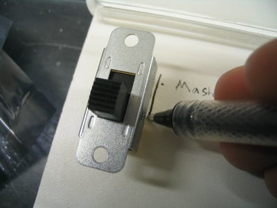

Step 3: The Control Panel - Mounting Components

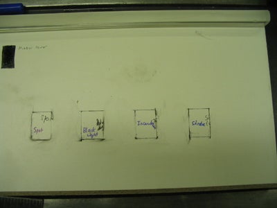

First thing you will need to do is make the layout of the control panel. I recommend planning the layout on the computer or on a sheet of paper before you mark the box, but it is up to you. Plan where you want the switches, LED indicators, headphone jacks, or other outside components. Place the components on the panel in their approximate location and check to see of that is where you want them.
Now, you can mark where you will be putting everything on the box (you will most likely want to do this in pencil lightly so you can erase leftover marks later).
Now, select a drill bit that is slightly larger than the jigsaw blade but smaller than the soon to be hole. Drill on the outside edge of the soon to be hole. Repeat for all switch locations, LED locations, etc.
Next, take the jigsaw, and starting on the outside edge of the hole, cut on top of the lines you drew. You will have to maneuver the blade around for the first part to get everything complete.
TIP: If you use melamine or other laminated wood, use a metal blade to cut to reduce surface chipping. Cut slowly and carefully. The chips that do appear can be lightly filled in with matching paint.

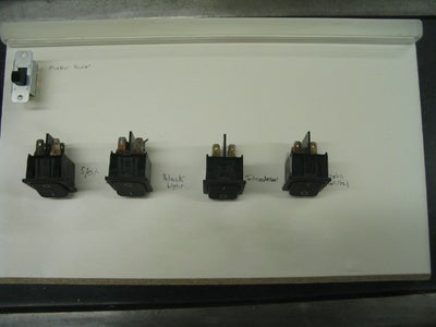

Once you have cut out all of the component locations, check to make sure the components fit into their spot and glue them into place.
TIP: If you cut the hole too big for any of the components, just fill in the extra space with hot glue and paint over it later.
Once all components are glue into place and fit properly, you can begin wiring.

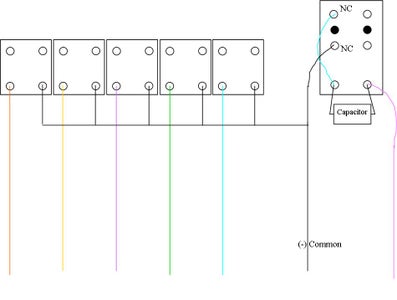

Step 5: Lights - Strobe Light (How to Make)

Reasons to not want to use relays
Relays are noisy when cycling on and off and on, so there will be a continuous click click click whenever partying. (If the music is loud enough you won't though!) Also, CFL's take time to warm up, so the first minute or so of strobing will be slightly dim unless you let the bulbs warm up before you strobe them. Lastly the relay pulses, your wall current alternates between + and - hence Alternating current. The sine wave will have high and lows and the RMS (Root Mean Square) is the middle. The relay will sometimes open below the RMS (120v) and sometime above making some flashes brighter and some flashes darker than others. There isn't any way to fix this without actually buying a strobe unfortunately. The reason I have two bulbs going simultaneously, is because the more bulbs there are, the harder it is to notice. CFL's probably don't like flashing either That said, let's continue:
Here's the original and number 2 prototypes.
How to Build a Relay Strobe Light
Parts:
Relay with 2 sets of normally closed contacts (make sure it is rated for 120VAC and at least 1 AMP)
Jumper Wire
Capacitor - Depends on the size and power of your relay. You'll see what I mean later.
Step 1: Connect the jumper wire from one of the NC pins to one of the coil pins
Step 2: Add the capacitor across the two coil terminals (bigger the capacitor the slower the strobe)
Step 3: Add one DC in wire to the opposite coil terminal of the jumper, and the other wire to the other NC pin. (See Picture 6)
Step 4: That's it! All you have to do now is try different capacitance values and connect the other NC wires to a light.
Here's it built and working: https://www.youtube.com/watch?v=K-IRPsM4aDo
First clip is with no capacitor
Second is with high capacitance (slow strobe)
Third is with low capacitance (fast strobe)
Fourth is dimming an LED

Step 1: If not already done so, mount your relays you will be using on the rail, or a board. Hot Glue works great. If you want, mark the two coil pins and the Normally Open pins with a sharpie so you don't forget.
Step 2: Take the other end of that 20+ foot cable and Strip of one half an inch off of every wire.
Step 3: Using the "Continuity Function" (makes a beep when things make a connection) on your multimeter find which wire corresponds to what. Start at the control panel end and using dashes, mark everything how you want it. For me: Strobe is 2 dashes, CFL is 4 dashes, Black is 1 dash, spot is 3 dashes , master power is 5 dashes. Make these dashes on the wire with continuity with a fine point sharpie.
Step 4: Now, solder one wire to one pin per relay and the common pin (-) to all the relays.
Step 5: Now, connect the neutral wire of all the lights to one pin of the normally open side of the relay.
Step 6: Attach a power cord to the whole mix by taking the HOT wire and attaching it to the HOT of all the lights. Then, take the Neutral wire of the power cord, and attach it to one pin of the master power relay. Lastly, take some wire and link together all the neutral pins of the relays with the neutral pin of the master power relay.
Everything is now connected, all you need now is a power supply to test everything out.

Step 11: Test Electronics
Not much to this one, just hook up your power supplies to the switches
https://www.youtube.com/watch?v=VvCLGQzY-oc
It works!
It works!

Step 13: Put It on the Ceiling and Get Partying!
Here's the video from it working . Did not have time to plan a party : ( Oh well! I will have it for when I do though! Thanks for looking at my Instructable on how to make your own party light system! Please vote for me in the Party Contest!
