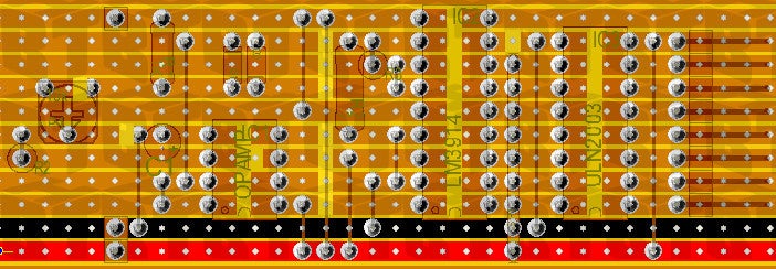

Step 2: Construction - Circuit Board
As mentioned you need no electronics experience to complete this project. As long as you assemble the components as described you will be able to build the igniter. You should practice soldering if you have not done so before and watch some tutorials on Youtube to get some tips on technique.
Circuit Board
The circuit will be assembled on strip board or some times called Variboard. This is a non conductive material like fiberglass that has strips of copper to build our circuit on. The piece you have been supplied will almost certainly not be the correct size so we need to cut it down. I have tried to reduce the size of the circuit as much as possible so it will fit in a hilt. Count 31 holes along the length of one side and score it with a sharp knife. If you bend slightly it should snap cleanly. Count 12 holes in the other side, score and snap here also
Step 3: Construction - Adding Components
Using the schematic start adding components to the circuit board. Start with the lowest profile parts first like wire links and Zener diodes. Note the Zener diodes are polarized (need to go in a specific direction). When you insert the parts turn the board over and solder them in place. If you put all the parts in at once some will fall out when you turn it over so just build the circuit up.

The Zener Diodes and capacitor must go in the correct orientation or the circuit will not work. The capacitor is marked with a white strip or - mark. The Zener Diodes have a black paint mark. The IC's have a notch at one end and this notch needs to be at the top for each chip. The gap between each track on the circuit board copper side is very narrow and it is quite easy to accidentally bridge across. In the photos I have used IC sockets so I can pull the chips out if I want to use them in other projects. This is optional but for a few cents it is worth the expense as it is easy to damage an IC if you try and desolder it.
Step 4: Construction - Resistor Network
For this circuit to work we need a network of Pull-Up resistors on the outputs of the LM3914. If you are lucky you can buy these pre-made from the local shop. Just ask for a 10k resistor array, you will have to chop of one of the legs otherwise the +ve and -ve will be on the network at the same time.
The other method is to make the array. Take one of your 10k resistors and bend one leg at 90 degrees. Collect another 6 and do the same so all bent legs are joining. Solder all these legs together letting the last resistors leg separate from the rest as this needs to connect to the +ve strip. Insert the array in the circuit board making sure the common leg is going to the correct supply.

Before completing the circuit we need to make cuts in the tracks as we don't want all the tracks conducting. Using the diagram mark the board with a pen and then cut the tracks with a sharp knife.
