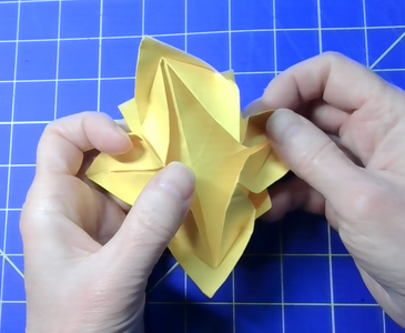

Cut 8.5 X 11 paper into a square, or use 8 inch square origami paper. To fold the lotus:

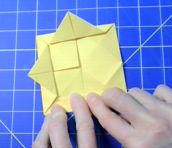

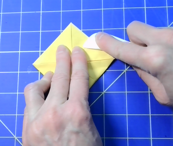

1. Fold and unfold corners.
2. Fold and unfold edges.
3. Fold corners in, envelope style.
4. Repeat.
5. Flip over and repeat. Make sure creases are sharp (use a bone folder or soup spoon). Then unfold it.

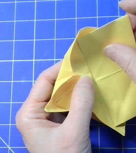

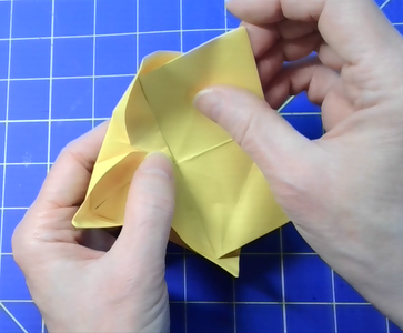

6. Flip over again. Fold corners out, about 1/4 of way from edge.

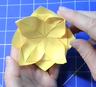

7. Flip over again. Fold corners in. Paper will curl up and form inner petals.
8. From underside, pull corners up – letting paper curl – to form outer petals.

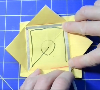

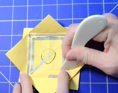

Unfold the inner petals and flatten. The circuit will go inside the square marked by creases. To lay out the circuit:

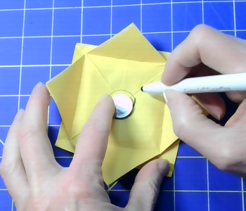

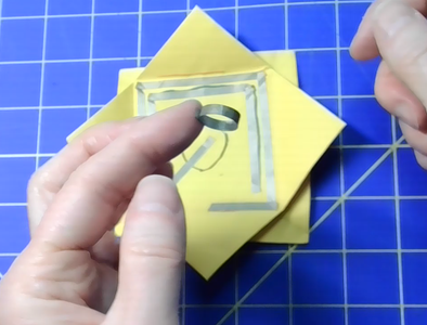

1. Trace around the battery in the center. Set the battery aside.
2. Start with conductive fabric tape at one corner. Lay it around three sides, then go halfway into the fourth side and stop. This is the positive side of circuit.
3. For the negative side, start with the tape inside the circle you drew for the battery. Go to the first corner – stopping about 1/8 inch from first line of tape. Turn and go around the first three sides, parallel to first line of tape. Make sure you don't touch it! Stop at the last corner.
Step 3: Add the Components

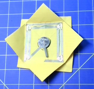

The battery goes in the middle where marked, positive (+) side up. To hold the battery in place, make a loop of conductive tape, sticky side out. Press it down in the spot for battery, and attach the battery.
Place a Circuit Sticker LED at each corner. Use extra conductive tape to make a good connection. Be sure the positive and negative ends of LEDs touch the correct tape only.
To add reed switch, bend one wire to side. Lay wire over end of positive tape. Use more conductive tape, or a conductive tape patch, to hold in place. Or wire goes on top of battery. Bend wire if needed. Attach the battery with conductive tape – making sure the tape does not touch sides or bottom of battery.

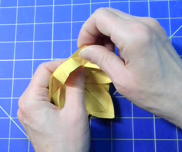

Fold petals back in place.

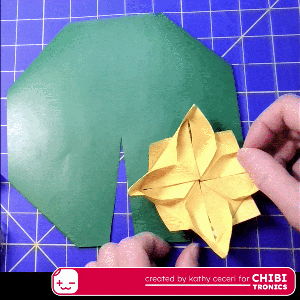

To make the lilypad base, take a green square and cut a narrow wedge out of one side. Flip over and fold each corner under. Slip the magnet inside one corner flap. Tape the edges closed to make a pouch that holds the magnet in place. (If the magnet is small, tape it right to the paper so it doesn't slide around.) Flip the lilypad right side up again.
Place the lotus on the lilypad, over the corner with magnet. The reed switch only works if it lines up with the magnet's field, so rotate the lotus like a knob to turn on and off!
