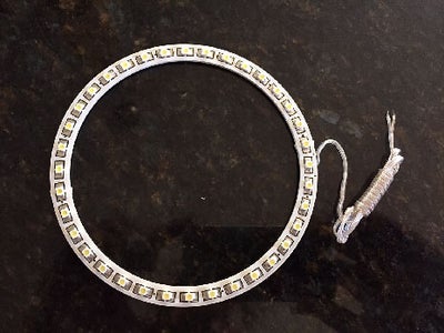

All you need is an LED ring, some wire, some double sided tape and a power source. You can try to find the right voltage (most likely 12v) in your machine in which case you will need a volt meter. Otherwise any external power source rated for your LED ring will be fine.
I used the 12cm 12v LED ring below:
12cm ring with 36 LEDs
8cm ring with 24 LEDs
Step 2: Prep the Ring
The ring looked great from the front, but there was one issue. The back of my ring had exposed contacts. In order to prevent these contacts from shorting out on the metal of the mill, I put my double sided tape over each exposed junction. It was a bit excessive from a taping perspective, but it prevents shorts.
Step 3: Install the Ring
You may need to remove DROs or other things attached to your spindle in order to get the ring to pass up to the mill body. Do what you need to get access to where you are going to be sticking the ring. Before installing the ring, clean the machine with alcohol where you are going to stick it. Stick your ring in place. Don't worry about wiring anything up yet. Once the ring is installed, the wiring should be self explanitory.
Step 4: Route Your Wire
Depending on where you found your power source, you will need to run wire from the power source to the spindle. I found a twelve volt transformer in my machine so tapped into the power there. You can absolutely use an external power source as well. From the transformer I ran the wire through a conduit to the mill head. It was a lot more involved than I had anticipated, but it kept the wire routing super clean. Keep in mind that when you run your wire, make sure its clear of any moving parts. Also make sure your wires have a little slack. Once your wire is in place, connect your wires and test to be sure the ring lights up.
Step 5: Thats It!
In addition to the ring, I added a switch so I can turn the light on and off. Above are my before and after images. The actual result is much more impressive than what the photos show. As you can see by the brightness of the wall in the background, the camera compensated for the brightness of the LEDs
