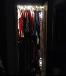

Got any unused holiday light strings and a closet that doesn't have a built-in light (as is often the case in older homes)? Have too many shadows in your closet? Those LED push lights from the dollar store don't cut it? I'm showing a way I lit up a dark closet with unused light strings. I could do the same with LED light strings as described in another Instructable, but I wanted to use some spare light strings. Since the lights are only on sparingly, the amount of electricity used with LED or incandescent lights is negligible.

After wrapping the lights around the inside of jamb, I added extra protection from rubbing by the corner rings by covering the wire in short pieces of unshrunk heat-shrink tubing (sliced lengthwise and slipped over the wires).
As a closet without an original light is unlikely to have an outlet, I put a hole in the wall and ran an extension cord (made from lamp wire and plugs) from the light string to an outside outlet. Now my wife and I appreciate having nicely-lit closets!
