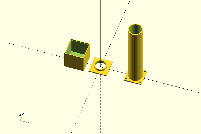

Step 3: 3D Print Your Lightning Pylon
Problem Mounting the AS3935 Inside the Box
We installed the MOD-1016 containing the AS3935 on the header provided on the WeatherPiArduino board. You can see it installed in the center of the picture below.
The AS3835 Breakout Board Installed on WeatherPiArduino
This turned out not to be a good location. Too much noise from all the other components surrounding it. We were getting interrupts telling us to adjust the noise floor and then you had to be right on top of it with the lightning simulator to get any response at all. We needed to move it away from the other electronics. In hindsight, we should have known that this would happen. The solution? Move it away from the box in a pylon. We thought of moving the WeatherPiArduino into a pylon, but we decided to just put an AS3835 in the pylon. See the 3D Print files above. Below is what the three parts look like on the screen in OpenSCAD and then it is followed by a picture of the pylon printed and installed on the WeatherPi Box. Here are the OpenSCAD files for the pylon.
The 3D Printed Parts of the Lightning Pylon

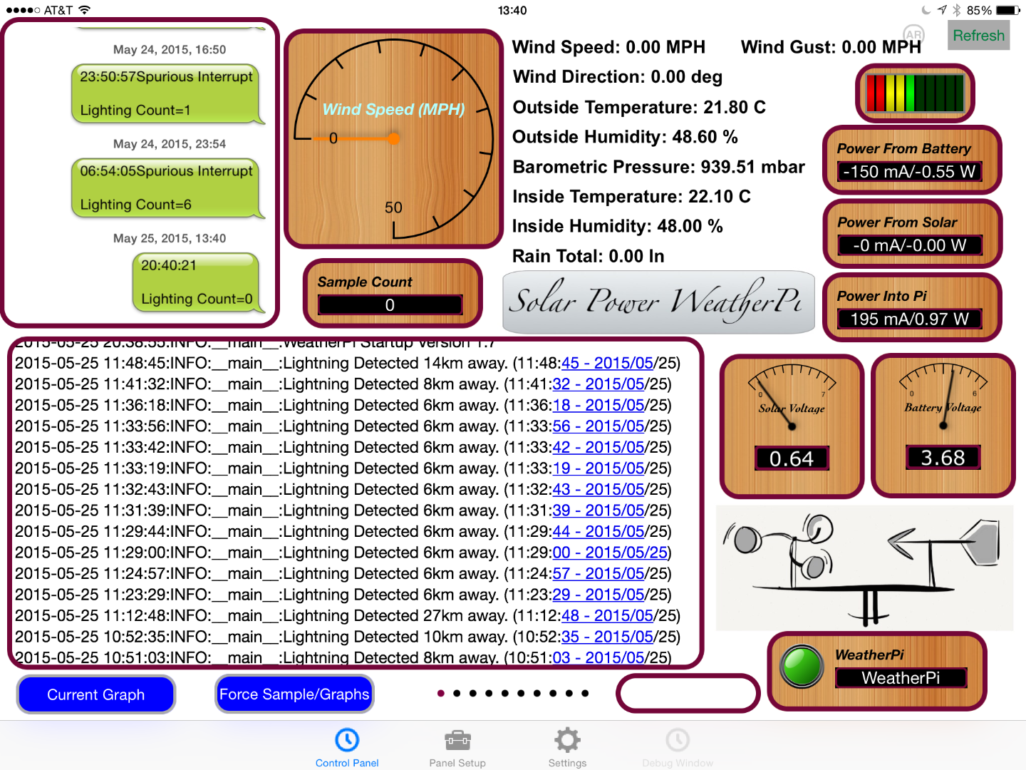

Step 5: See the Real Results!
We have been running the AS3935 breakout board in the WeatherPi pylon for the past 5 days. We have had two thunderstorms come through during that time. The first storm was pretty week and just moved through north of SwitchDoc Labs. Our president, Laurel, was out playing golf (the benefits of power and position) and she called us to tell us that the lightning storm had come by, and we got to tell her that we already knew. Below are the lightning logs from our RasPiConnect control panel. Note that there was no wind measured during as we had the WeatherRack Weather Sensors disconnected as it was plugged into Project Curacao (and did pick up the wind), which is heading to the tropics shortly.
Next up was a big storm two days later that really rocked! You can see (reading the log backwards according to UTC timestamp) the storm approach and then go by and depart. Came within 6km of SwitchDoc Labs.
And it texts us reports too!
