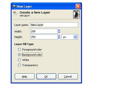

Step 2: NEW LAYER
Click Layer new layer. Click foreground color and make sure it is black.
