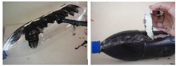

Step 1: Mask and Paint Bottle
    Stick a line of masking tape down side of bottle, this will become a window, so that you can see how much water there is left.
    Paint bottle black, this will help catch more heat from the sun to heat up the water inside.
    Wait for paint to dry then peal masking tape.
    If you are using paint that peals, wait until the rest of the project is complete before painting to get longer shower life.

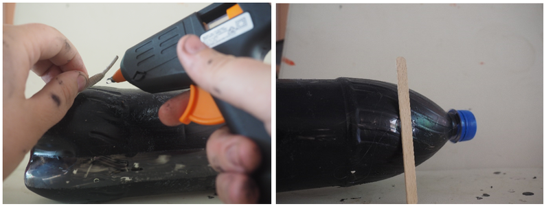

    Step 2: Glue String and Sticks
      Use a glue gun to glue the ends of the strings on opposite sides of the bottle near the base. Glue the middle of the sticks onto bottle above where the strings are glued so that if the bottle sits upright they are horizontal and near the top of the bottle as pictured.
      Allow to cool.
      It's a good idea to fill the bottle with water now, although it is not necessary.

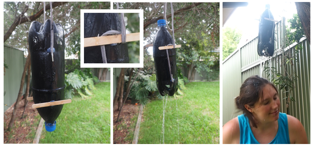

        Step 4: Use Shower
        To use your new shower:
          Fill with water (you will loose some water as you screw the lid on, this is ok.)
          Tie the strings to a tree branch making sure to leave enough string to flip bottle.
          Allow the shower to hang in the sun to heat the water. (The amount of heat will depend on the suns heat and how long it is in the sun.)
          When you are ready to shower, flip bottle and twist the string around the sticks (as pictured) to keep it that way up.
          To adjust the water flow tighten and loosen the bottle lid.
          Enjoy your shower!

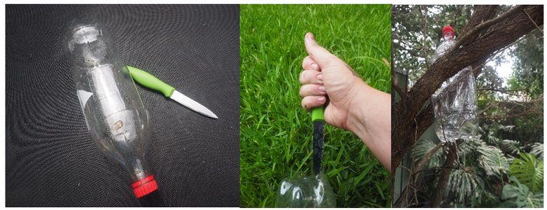

          Step 5: Bonus Campsite Build
          Already camping? Didn't bring craft supplies?
          Here is a quick and easy shower.
          You will need:
          • bottle
          • knife
          What to do:
          • Fill the bottle with water.
          • Use the knife to put holes in bottom of bottle.
          • Jam bottle into a fork in a tree.
