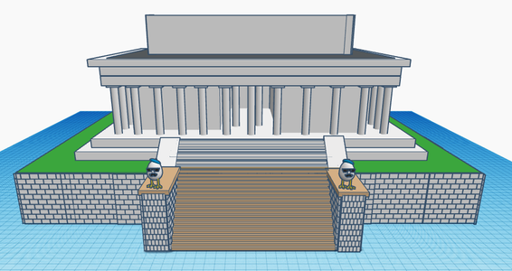

I made the Lincoln Memorial on Tinkercad for fun.
This is a link to my final product.
Tips: Use duplicate (ctrl + D) to make most of these shapes, otherwise it's a pain to make each individual column, or even to make any of the square based shapes.
Computer, Tinkercad program
Step 1: Column
Make a column using a cylinder and a flattened cube. The Lincoln Memorial has Doric columns.
Step 2: Arrange the Columns in 12x8 Rectangle.
There should be 36 columns total.
Step 3: Add the Base
Add two large steps underneath using a long flattened cube.
Step 4: Add Grass Platform
Add the grass and the surrounding bricks using the brick wall shape under “All” under “Shape Generators”
Step 5: Add the First Layer of Stairs
Add the first layer of stairs, 10. There is a stair shape under “All” under “Shape Generators” but I just took a bunch of long flat cubes.
Step 6: Add the Second Layer of Stairs
Add the second layer of stairs, 21 and the sidewall pieces, again using the brick wall shape and a flat cube on top.
Step 7: Add
Add two roof pieces made of long flat cubes and the statue on the second stair wall, I made an egg.
Step 8: Inside
Add the walls to the inside.
Step 9: Add the Roof Windows
Add the roof box and surround it with white pieces and add triangles using the “roof” shape, these are the windows.
