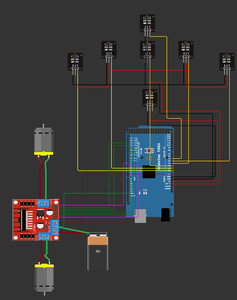

Step 3: Wiring
Wiring Steps:
1. Connect the Motor Driver to the Motors:
  1. Motor 1:
  2. Connect one terminal of Motor 1 to the OUT1 pin on the motor driver.
  3. Connect the other terminal of Motor 1 to the OUT2 pin on the motor driver.
  4. Motor 2:
  5. Connect one terminal of Motor 2 to the OUT3 pin on the motor driver.
  6. Connect the other terminal of Motor 2 to the OUT4 pin on the motor driver.
2. Connect the Motor Driver to the Arduino:
  1. Motor 1 Control (ENA and IN Pins):
  2. Connect ENA on the motor driver to pin 3 on the Arduino.
  3. Connect IN1 on the motor driver to pin 15 on the Arduino.
  4. Connect IN2 on the motor driver to pin 17 on the Arduino.
  5. Motor 2 Control (ENB and IN Pins):
  6. Connect ENB on the motor driver to pin 2 on the Arduino.
  7. Connect IN3 on the motor driver to pin 18 on the Arduino.
  8. Connect IN4 on the motor driver to pin 19 on the Arduino.
3. Power Connections:
  1. Battery:
  2. Connect the positive terminal of the 9V battery to the VCC pin on the motor driver.
  3. Connect the negative terminal of the 9V battery to the GND pin on the motor driver.
  4. Motor Driver Power:
  5. Connect the GND pin from the motor driver to the GND pin on the Arduino.
4. Connect the Line Sensors to the Arduino:
  1. Sensor Array (5 Sensors):
  2. Connect the OUT pin of each sensor to the following analog pins on the Arduino:
  3. Sensor 1 (far left): A0
  4. Sensor 2: A1
  5. Sensor 3 (center): A2
  6. Sensor 4: A3
  7. Sensor 5 (far right): A4
  8. Connect the VCC pin of each sensor to the 5V pin on the Arduino.
  9. Connect the GND pin of each sensor to the GND pin on the Arduino.
  10. Front Sensor:
  11. Connect the OUT pin of the front sensor to the A5 pin on the Arduino.
  12. Connect the VCC and GND pins as described for the sensor array.
  13. Back Sensor:
  14. Connect the OUT pin of the back sensor to the A6 pin on the Arduino.
  15. Connect the VCC and GND pins similarly.
5. Additional Digital Sensors:
  1. Right Side Sensor:
  2. Connect the OUT pin of the right sensor to the digital pin 24 on the Arduino.
  3. Left Side Sensor:
  4. Connect the OUT pin of the left sensor to the digital pin 22 on the Arduino.
  5. Power the sensors using the 5V and GND connections from the Arduino.
Final Checks:
  1. Ensure All Connections Are Secure: Double-check that each wire is properly connected and that the pins correspond to the correct assignment in the code.
  2. Test the Wiring: Before running the full code, verify that each motor responds to the control inputs and that the sensors are providing the expected signals.

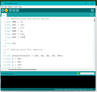

Step 4: Programing / Testing
Code Explanation:
Setup and Initialization:
  1. Motor Control Pins: The motor driver is controlled through specific pins (ENA, IN1, IN2, ENB, IN3, IN4) assigned to the motors.
  2. Sensor Pins: Seven sensors are used to detect the line and surroundings (sensorPins[5], f, b, r, l).
  3. PID Constants: These values (Kp, Kd, Ki) are used to fine-tune the robot's movement, ensuring it follows the line accurately change it based on your robot behavior.
  4. Variables: Several variables are initialized to store sensor readings, PID error calculations, and motor speeds.
Calibration:
  1. The calibrate() function runs the robot in a circle to detect the minimum and maximum values of the sensors, determining the threshold for line detection.
Main Loop:
  1. Initial Calibration and Movement: Once, the robot calibrates itself, it makes a slight turn to align with the line and then starts moving forward.
  2. Sensor Readings: The robot continuously reads the sensors to determine the position of the line.
  3. PID Calculation: The error between the desired position and the actual position is calculated. The PID controller uses this error to adjust the speed of the motors (leftSpeed, rightSpeed) to keep the robot on the line.
  4. Movement Logic: Depending on sensor inputs:
  5. Forward: If the robot is on track, it moves forward.
  6. Turns: If the robot detects a turn, it adjusts its direction (left or right) accordingly.
  7. Special Cases: There are also provisions for handling complex situations, such as sharp turns or U-turns, but some are commented out.
Functions:
  1. Movement Functions (forward, turnRight, turnLeft): These control the motors based on the speed and direction needed.
  2. Error Calculation (calculateError): Computes the error by averaging sensor values to keep the robot centered on the line.
After uploading the code to your line-following robot, it's crucial to test and fine-tune the code based on how the robot behaves in real-world conditions.
