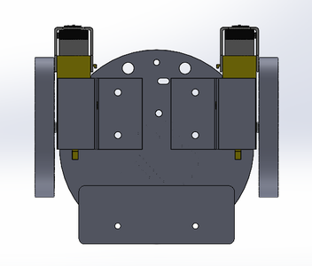

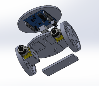

Step 2: Design

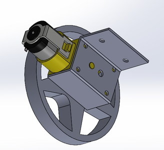

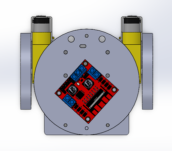

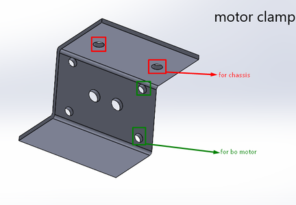

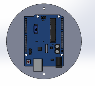

I designed the motor clamps and chassis in Solidworks and tried to assemble the parts and components to get an idea of the final outcome. There are three chassis: top chassis for mounting UNO, bottom chassis for mounting motors and driver(there is provision for battery also) and third chassis(caster wheel and ir mount) for mounting caster wheel and IR LEDs
I am attaching the STL file for motor clamp and DXF file for the three chassis and circular spacers(for bolts).

The bot is divided into three chassis: on the bottom chassis I have mounted driver and motor and given the provision for battery to mount underneath the bottom chassis, on the top chassis I have mounted UNO and on the third chassis I have mounted caster wheel and IR LEDs PCB. The third chassis is suppose to be mounted onto the bottom chassis with the help of long bolt(3 inch) and top chassis is suppose to be mounted onto the bottom chassis with the help of standoff spacer. Refer to the images provided in the design step for reference.
While designing I had given the provision for all the holes on the chassis and motor clamp except for the IR LEDs PCB and caster wheel. For that I manually drilled the holes in PCB and the third chassis. Use cable ties to tidy up the wires.
