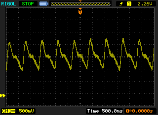

Any QUAD OPAMP that can operate at 3V can be used. In case the SpO2 Sensor is not available a DIY sensor can be designed as shown.
Construct the circuit as show in the schematic shown below.
Burn the attached HEX file on the Controller via the debug port using a MSP430 Launchpad and IAR workbench.

Step 5: Testing!!!
Connect the Wifi Antenna and battery to LinkIt One board and also mount the Addon Board on LinkIt One. Connect SpO2 probe and put it onto a finger and switch on power.
The heart rate data can be seen on the cloud application which updates periodically.
