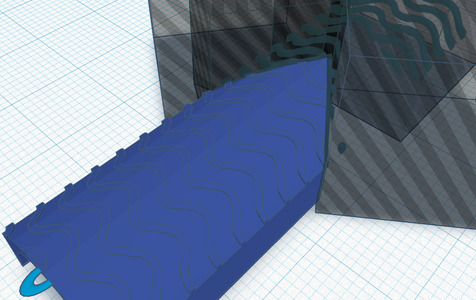

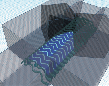

Step 1: 3D Design
Use Tinkercad to create a 3D model of one link. Starting with one cylinder, a rectangle, and two squares. Use the cylinder as a hole to cut a semicircle from the bottom of the rectangle. Use the two squares as holes to make one end of the rectangle a point. Use the draw feature to create a wave pattern or the pattern of your choice. Then use the same squares and new rectangles as holes to match the pattern to the shape. Duplicate the shape and enlarge it. Use this new shape as a hole to cut out a crescent on the top of the main shape. Attach a flattened ring to the opposite side of the point. Attach three small cylinders to each other rotating each cylinder slightly at each joint to the middle of the underside of the shape. Then attach the sphere on top of the last cylinder.
