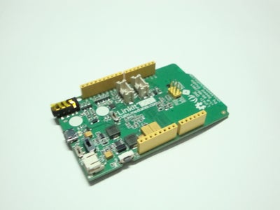

Introduction: Linkit ONE Music Player
This instructable will guide you to play and MP3 file on linkit one through a micro SD card. This projects makes use of the Audio jack and SD card reader features of the Mediatek Linkit ONE board.

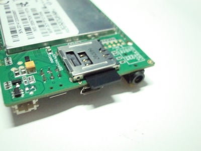

Step 2: Insert Memory Card and Connect Battery
Insert your memory card in the SIM/ Micro SD combo linkit one. Your SD card should be formatted first and then songs should be loaded.

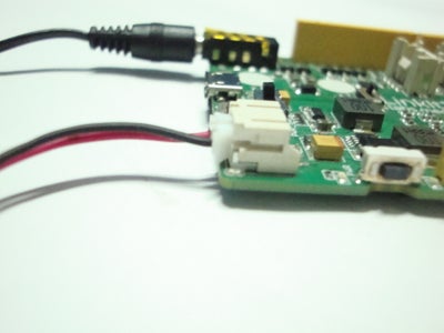

Then connect the lithium battery to the socket present on linkit one.

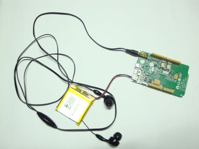

Step 4: Connect Speakers or Earphones and Play It!
Now connect your speakers of earphones to the 3.5mm audio jack on linkit one. Set the switches to MS, SD and BAT positions.
You will now be able to hear the song which you mentioned in the code
