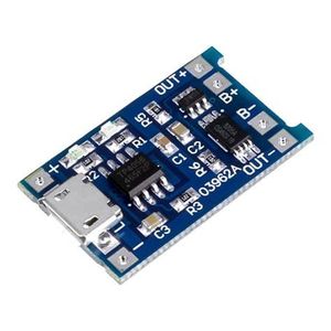

IC TP-4056 is a 1A stand-alone single lithium-ion battery charging module with 2 LED indicators for the indication of charging and fully-charged.
Red - charging
Blue - fully-charged
DataSheet:-
Input Voltage: 4-8 V
Output Voltage: 4.2V
Output Charging Current: 1A (Max) (Adjustable through Rprog)
